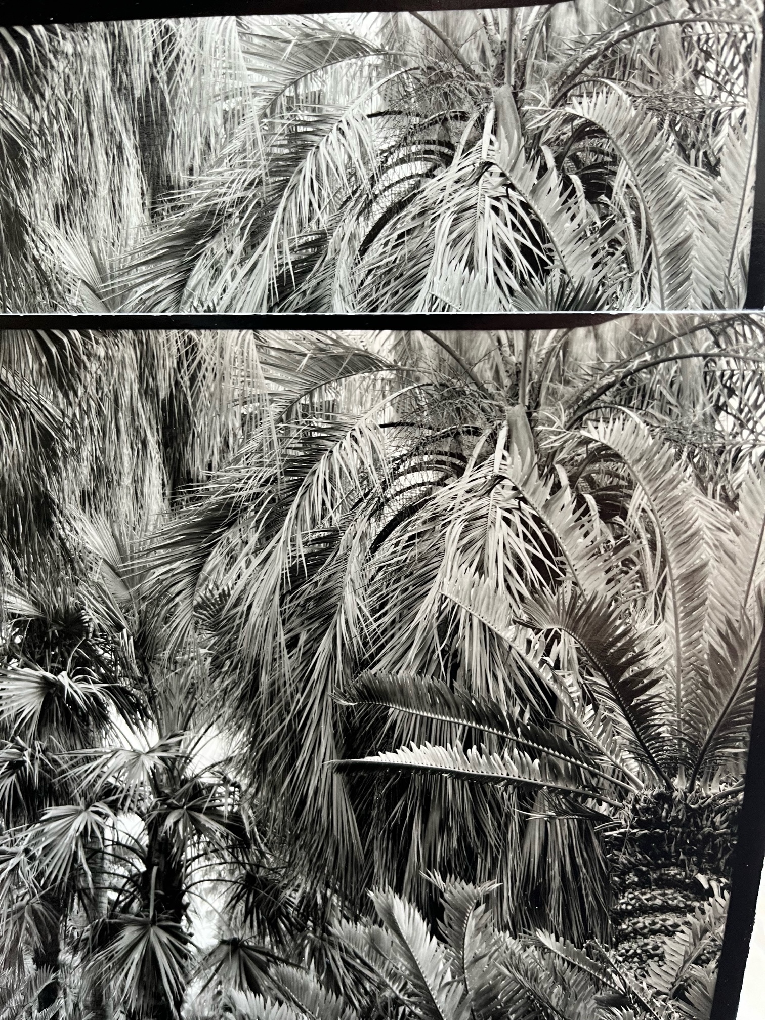

Indeed. All tonal subtleties lost on an iPhone, combined with print reflectance. (My skin tone is reflected in places as well. )You can see very crude color difference though.
Top: Lodima G4 in Amidol v7
Bottom: MGWT in Amidol v7, grade 3 1/2
