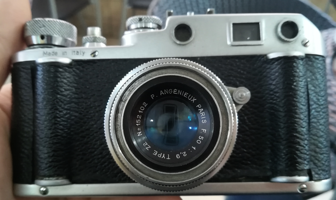

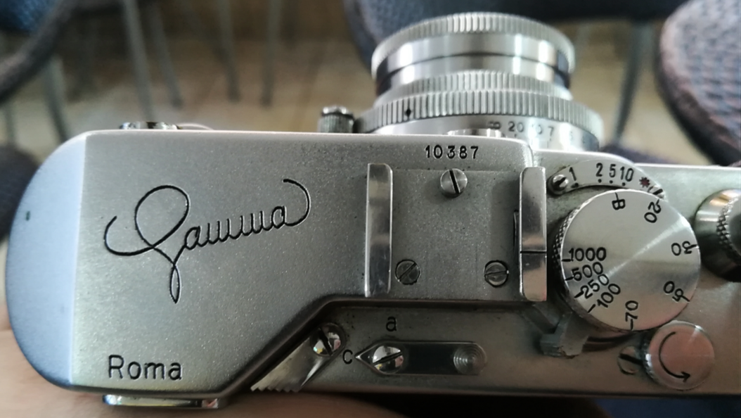

Hello guys, recently I acquired in a flea market a really nice camera that can be considered a Leica copy. It's a Gamma III with a Angenieux 50mm f/2.9, produced in Rome, Italy between the 40s and 50s and it's kinda rare.
It's in good cosmetic conditions except the leatherette that is kinda dry and lost its elasticity. There are no cuts and scratches on it but it's restricted. I'd like to save it and restore it to keep it as original as possible, is there a way to re expand it to its original shape without ruining it?
That camera also has two weird solid and curve shutter curtains that have to be lubricated. This is something a good repairman can do but would you recommend to restore the leatherette by myself?
Here two pictures of the item.

I discovered that it's leather, not leatherette! I still don't want to change it with new leather to keep the camera original, any advice?
Looking at the picture of your camera it looks like the leather has come unstuck and crept upwards towards the top of the camera rather than shrunk. There is gap towards the bottom of the camera and towards the top the leather looks buckled up. I think you would need to very carefully remove the leather, treat it to restore the lost oils (whilst off the camera so that there is no risk of getting muck in the camera) and then gluing the leather back in place. The leather is probably held on with shellac which will come loose with alcohol. You need to start at an edge and moisten under the leather with alcohol on a cotton bud. When then glue comes loose you carefully lift up that bit of leather and then soften the next bit of glue with more alcohol and so on. Do not attempt to remove the leather without softening the glue or you will just tear it to shreds. Of course if the leather is very dry and brittle it may be too dangerous to try to remove it. In that case you could just try Neats Foot Oil.
