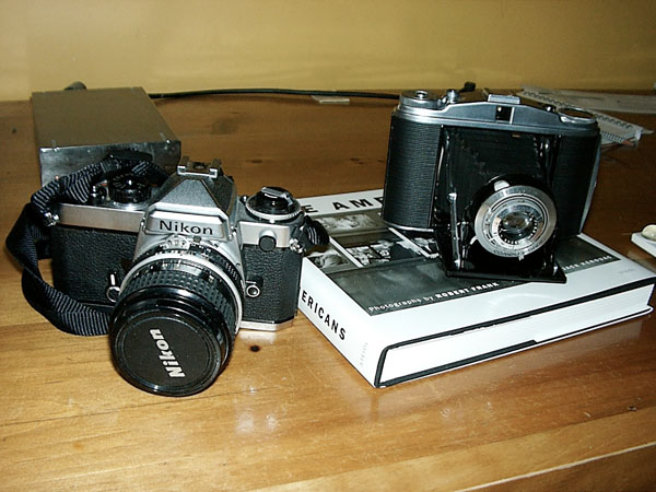

In Canada today...

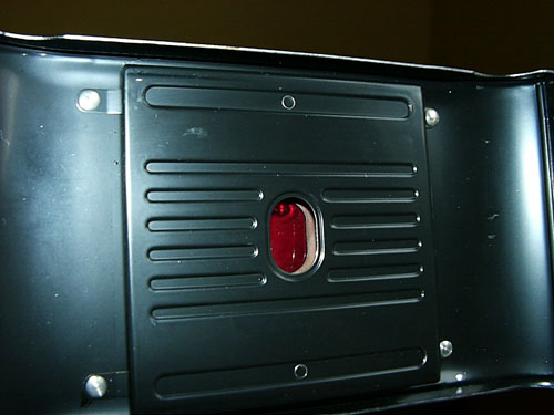

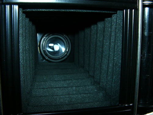

There was the sound of me saying YEAH! as I received a pristine Isolette II.
And by pristine, I mean pristine. I attached a few pictures to show the quality of the job. Everything is smooth, clean, scratchless, spotlessly clean, and fluid.
My donation to APUG is on the way, and I pledge that if I ever neglect to use this camera, that I will give it back freely to someone here who could use it.
Thank you for a most amazing day.
PS: And it's so tiny! Not bigger than a 35mm camera. Oh, and The Americans is shipping now!
