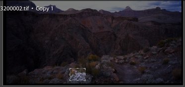

OK, best I could do as I'm kinda busy....
The image, I haven't even cropped out the edges of the can yet......
The cropped area...
The scan at 3200 with Epson holder cropped 1:1 ...
The scan at 3200 with betterscanning holder and ANR glass cropped 1:1 ...
It's certainly not super great, this was Provia 100F, I seem to do a lot better with B&W film than color, but this is SUCH a tiny part of the frame, you could blow this up really big and not see any blur. I don't have technical understanding of film and scanning and all the tech side, but this looks really sharp even larger than 20x24.
Hope this is in some way helpful.

That's quite a difference between the two holders. It should be convincing to people that you can get significantly better results from the Epsons with a new holder and some time for adjustments.
Also, leaving the edges in the scan lets me see that you got the exposure right in the scan. It also looks like you are getting better shadow detail out of the V750 than I am on the 4870, but that's hard to say for sure without scanning the same piece of the film. But I have never been satisfied with transparency scans on the 4870, even for proofing.
I tried my best to leave them untouched, I believe the output file does a "for screen sharpening" but nothing of significance. But the clarity and sharpening can be increased both in scan and post scan, but I didn't do either. I'm also lazy so the betterscanning can also probably be tuned in MORE, I just don't have the patience to mess with it.
