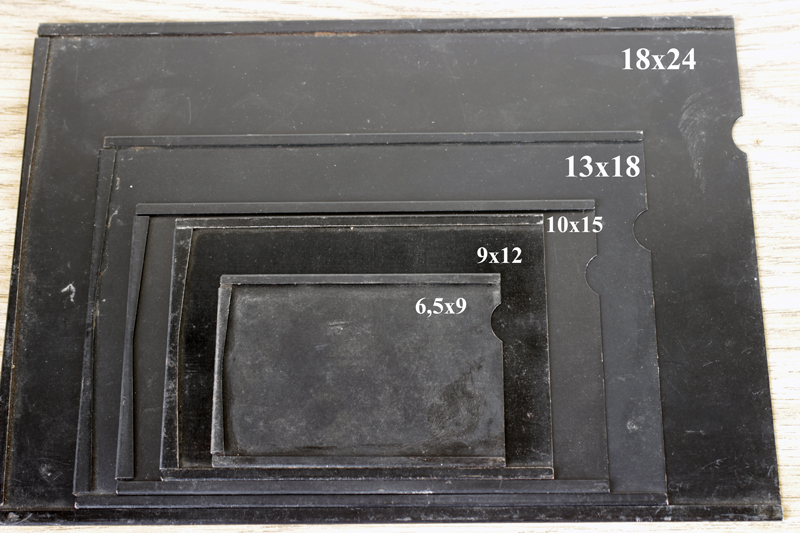

Hello,
Here are some measures of european plate format.
They are dimensions of septums used for film for plate holders ; septum dimension is same as plate dimension.
I use the septums for old cameras ICA, Zeiss-Ikon, Voigtlander, Gaumont, Gilles-Faller and others "noname"
format 18x24 : 18 x 23,9 cm
format 13x18 : 12,9 x 18 cm
format 10x15 : 9,9 x15 cm
format 9x12 : 9 x 11,9 cm
format 6x9 : 6,5 x 9 cm.
