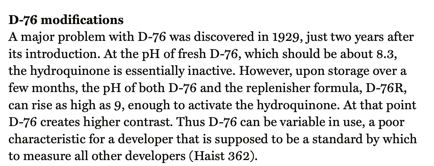

I can see bromide build up being a problem. In fact a while back I was experimenting with adding bromide as an anti-fog to try and salvage some found 70mm film(decided it was just wasting my time since I never could positively ID the film and realized base fog was so high that I doubted I'd get anything through it).
In any case, I definitely found a point where I added enough KBr that it just quit working. I was only playing with ~50mL at a time(developing film clips) and using a fairly concentrated KBr solution, but I definitely sensed that there was a "cliff" where too much just killed it completely.
With that said, I'm more focusing on this and other related comments in the Cookbook, and that's where my question about checking and adjusting pH came from
Personally, I'm beginning to doubt a lot of Haist's writings, and I have read both recent volumes. Instead, I rely on LFA Mason's Photographic Processing Chemistry, edited by the head of Kodak Research, for Focal Press.
I don't know where your quote is from, but it does not match many years of use of D76/ID0-11 and other clones as an industry standard developer, by almost all professional photographers shooting B&W, for decades.
I would add that Haist couldn't even refer to the original Eastman Kodak Research precursor to D76 correctly, so clearly lacked full knowledge.
Haist quotes no primary sources, LFA Mason does. Anyone who has been to University know you HAVE to quote primary sources, and that's even more important to Post Grad qualifications, So in that respect Haist's books could be fiction, of course they are not, but then they are not verifiably accurate either.
Ian
This came from the Film Developing Cookbook 2e by Troop and Anchell.
I have found some of the chemistry in it somewhat questionable in a read through. The cookbook leans heavily on Haist and Crawley both, and yes it is certainly at best a tertiary source since it does not cite any primary sources. It's a relatively "fresh" reference also as it was published in 2020.
With that said, I am asking about it here because it is from at least a recognized/current source(and one cited often on here) and is contrary to a lot of this discussion.
I have started working through Haist's volumes, although put volume 1 aside for a little while because I got tired of reading about the wonders of monobaths.
I will find a copy of Mason as you've cited, but can you suggest some other good primary source material or some well-sourced secondary sources?
(and yes I'm well aware of the importance of primary sources-I do have some pieces of paper on my wall as well as a job title that says I know not just how to read and reference primary sources in chemistry, but also to write them when appropriate...)

Reading Haist page 362-365 he also leans on Geoffrey Crawley's 1960 BJP articles. There's no mention of specific pH changes rather that after 7 weeks (49 days) activity has increased compared to fresh un-replenished developer. He states that D76d does not have this shift in activity of plain D76, the Boric Acid Borax combination is ab effective pH buffer.
Commercial D76 has been buffered with Boric Acid for many years and Australian packaging indicates the change to be 4g Borax and 2g Boric Acid. An Ilford Patent contains a reference developer indicating ID-11 buffering increased from 2 to 3 g Borax per litre.
Ian
So in other words, the Cookbook is cherry-picking information from its main source and not accounting for commercial formulae changing to a buffered system.
The current SDS for Kodak D76 distributed in the US(assuming it's the same worldwide) lists Boric Anhydride as an ingredient along with sodum tetraborate. Of course I'd expect the anhydride to hydrolyze when dissolved in water to give boric acid, giving us the borate buffer.
So, now the question to me is-if formulating D76 at home, is it worthwhile to use a buffered formula and adjust the pH on initial mixing? Similarly, would it be desirable for the replenisher to be buffered to roughly the same pH as stock?

You don't need to adjust the pH. Unless you have very heavy throughput just the basic D76 is OK. If I went back to an MQ fine grain developer, I'd use Adox Borax MQ which I found gave finer grain, better sharpness, cleaner shadow details, and about a 1/3 stop faster than D76. It's closely related to the old ASA/BS standard developer for determining film speeds.
I did use Adox Borax MQ commercially for a few years and supplied a couple of local studios with it & the replenisher. It's very close to Agfa 487/Ansco 17. One of the disadvantages of D76 is it's nor a clean working MQ developer due to the silver solvency of a 10% Sulphite, it's not quite so simple because switch from Metol to Phenidone or Dimezone and that changes.

This (interesting) discussion reminds me of the often-repeated claim that D-76 changes activity during the first 24hrs after mixing. Seems to be an Internet case of circular confirmation. For sure, when I challenged that assertion on photrio, nobody came up with primary evidence (experimental or literature).
Could it be that it was born from the text quoted by @Ben Hutcherson in post #37. Itself based on writings of Haist, without proper primary sources. Plus a confusion between the "original" D-76, D-76d, and the commercial formula (see below)
FWIW I once measured the pH of D-76d during the first 48hrs and saw no change (yeees, buuut it's an effect more subtle than just pH...)
I now use the (possibly commercial) buffered version (4g borax 2g boric acid) after reading this and following posts:
