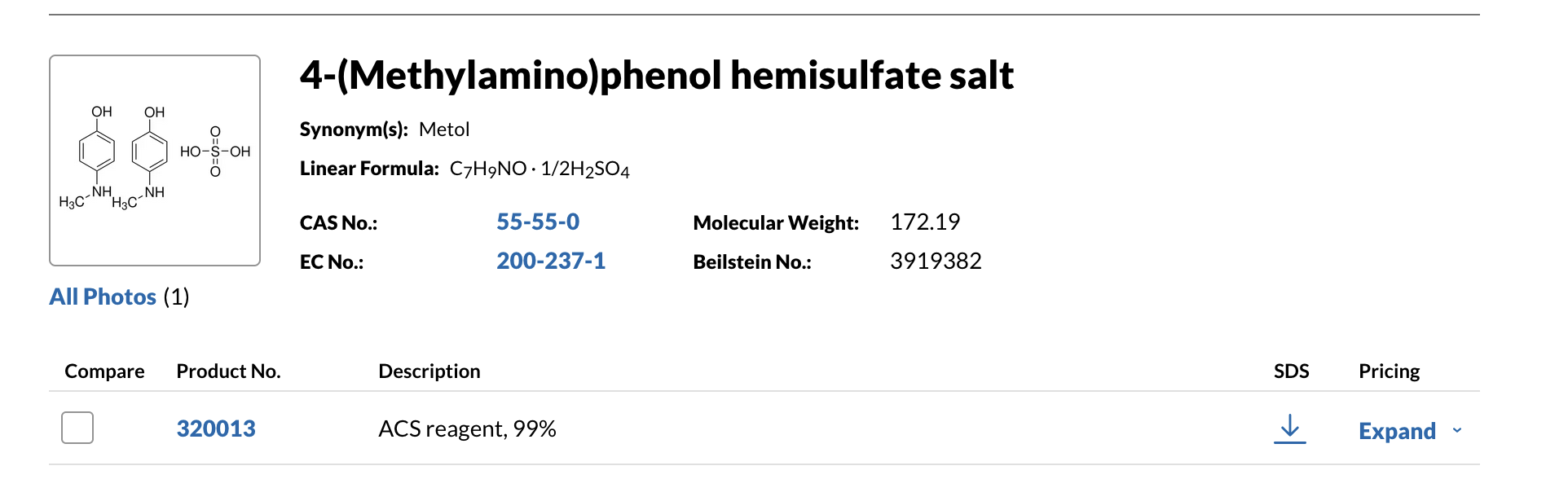

I have been considering running D76 replenished, but have held off because I like the look of 1:1 too much.
In any case, though, as I'm typing this I have a bag bought from my local camera store last week. It's marked with a production date of 1/2/2024, and an expiration date of 1/2027.
The "Hazard Information" lists it as containing hydroquinone, sodium sulfite, boric anhydride, and sodium hydroxide. None of those are a surprise. It also lists Bis(4-hydroxy-N-methynilium) sulfate with a given CAS of 55-55-0. Sigma-Aldrich returns this for that CAS, and gives both the familiar chemical name to me for Metol in the search results and lists Metol as a synonym.
And this site lists Kodak's given name on the packet
The 2019 revision of the SDS from K-A agrees on this(and adds a few more, again none of which should be surprising to anyone who's blended or looked at the formula for D76)
Just to be sure, I looked at the 2024 revision of the SDS from PSI, and at least as the major components go it is not appreciably different
I had seen this same information about now using a metol derivative, and had been skeptical of using home-brewed D76R with Kodak commercial D76, but based on the information from the product I have on hand and availalbe information I don't see any reason why not. Commercial still seems to be an MQ blend with a boatload of sulfite and some borax or borax-adjacent compounds, so I suspect it will be fine.
SDSs are deliberately vague to give as much information as needed for people handling the product without revealing trade secrets, but I'd consider it a major issue for them to claim the presence of something that's a known allergen/irritant(IDed by a systematic name and CAS) when they are instead using a different but related compound.
Knowing this, I may mix up D76R and see what happens, as I have a mixed but not yet used

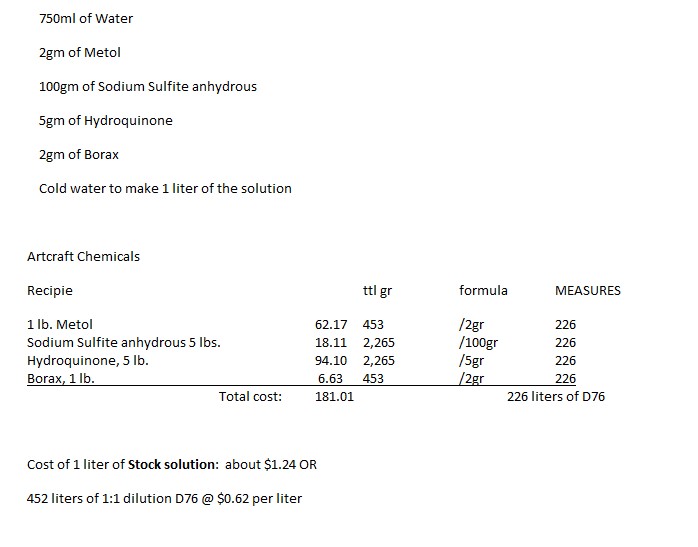

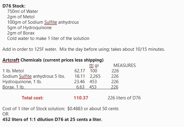

If you are looking to save money by replenshing, let me give you an alternative: Scratch mix D76.
Corrected/updated prices; Thank you Bernard for catching my error.

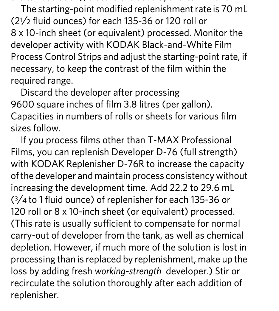

One more question for the group...

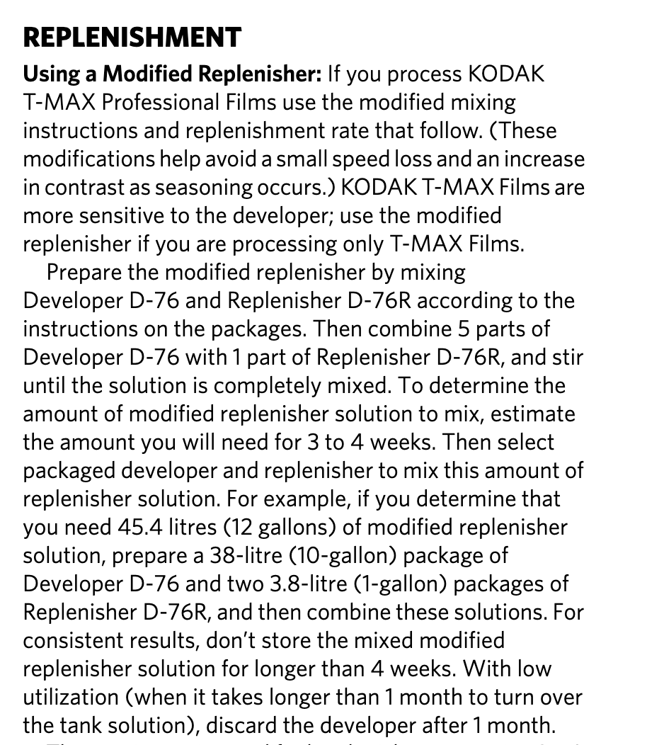

I was just reading through the replenishing instructions in J78 and it says that a modified D-76 stock, for processing and replenishment of TMax films, is only good for 4 weeks. I thought one of the primary advantages to using a replenishing routine is that the stock lasts for 6 - 12 months, depending, of course, on how much film is run. Why would the active life of the modified version be so short? Or, is this because TMax emulsions are exceptionally hard on the developer?

It is always important to remember that replenishment was mainly designed for high volume commercial labs.
4 weeks might mean 400, 4000, even 40,000 films for labs using D-76.
Don't use your replenished D76 on Tmax films. Use it for everything else. Tmax films will kill it.
I've been using D76 replenished for a while, now. I would not recommend attempting to replenish a purchased bag of D76. There are too many unknowns about what's in that bag. If you mix the recipes @Kino provided above, you're all set. Everything you use to mix D76R is also needed for plain D76. Makes no sense to scratch mix one and not the other.
Kodak prices for same: $900
I had mad a similar evaluation (attached file), appropriate for EU, based on prices of Suvatlar for Hydroquinone and Metol, and a household chemistry supplier for the rest. My result is 2.78€ for 1 litre of stock D-76. Cheaper than a 1-litre Kodak powder package; hardly worth the trouble in 5-litre quantity (but I can't use 5 litre stock before it goes bad).
I can't pinpoint the reason for the large difference between your result and mine. Only part comes from somewhat lower prices at Atrcraft, and from your buying larger quantities (assuming one uses 226 litres of stock D-76). I could not guess (maybe did not try hard enough) what ttl gr and MEASURES stand for. Furthermore, you seem to be dividing your total cost 110.37$ by the quantity 226 litres to obtain a unit cost 0.488$/litre, but the quantities you bought (and whose cost you add up) are not in the proportions of the D-76 formula. So it looks to me like 110.37$ is the cost of initial procurement, but not the (incremental) cost of 226 litres of stock D-76.
Can you please explain?
Side note: in my evaluation, the single largest contribution to the total cost is... sulfite, usually considered "cheap"; sure but there is 100g of it.
  • Prix_Revient_Produits.pdf
Kino
Jan 20, 2006
7,784
Orange, Virginia
Bernard,
Thank you for catching my error.
Forgive my aging brain, I went back and re-calculated my prices based on current Artcraft Chemical prices and found my lazy error in math: too much copy/pasting and not enough thinking!
I was trying to find the required quantities of each chemical that would efficiently use 1 pound (453 grams roughly) of Metol efficiently. I somehow fell into a trance and miscalculated the Hydroquinone amount/cost.
"TTL GR" is the conversion from Imperial to Metric weights, "formula" is what is required to make 1 liter and "Measures" is how many portions of a 1 liter mix that can be derived from that chemical.
Hopefully this now correct (probably not); the price is higher but still a substantial savings in cost.
I need to either double-check my calculations or just stay off the Internet...

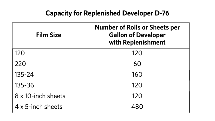

FWIW, in the datasheet, Kodak lists the following as the capacity for a replenished system. I read this is as "discard and start over" when you hit these amounts(2017 datasheet J78, from when D76R was still available, here https://business.kodakmoments.com/sites/default/files/wysiwyg/pro/chemistry/j78.pdf ). If you read a bit more into the details, they give 9600 sq. in. of developed film as the basis for these numbers. I also think of this in terms of a single sheet of 8x10, or 80in2 being a "standard unit" of film(my made up term, but hopefully makes sense given how it's referenced in a lot of processing documentation), and 1x 120, 1x 135-36, and 4x 4x5 are all equivalent to that number(back of the envelope math says 2 sheets of 5x7 will come a bit short of this-if you want to be exact 7 sheets of 8x10 have the same area as 16 sheets of 5x7, or that 274 sheets of 5x7 would be the aproximate capacity)
FWIW, I shoot at a volume where I'd probably come out financially ahead by replenishing, especially if mixing all from scratch, but bear in mind that they also recommend discarding and starting over after 4 weeks. Sometimes I use 2-3 gallons of D76 in a month, and sometimes I'm butting up against the the shelf life of a stock solution even using it 1 shot(although I've DEFINITELY stretched Kodak's recommendation for 2 months for a partial bottle, and in a pinch have used a partial bottle mixed 8 months or so before, but wouldn't have done that if I weren't developing purely for camera and lens function testing).
They also offer these instructions for TMAX film if you want to develop it in a replenished system. Note that this is stated as having a 1 month life before the whole volume should be discarded.
There's also these instructions for replenishment volumes to use for both TMAX and standard film
(the first paragraph refers to TMAX replenishment-it was cut immediately after the above text to avoiding having too long of a screen shot).
There's no discussion of replenishing mixed TMAX and conventional films. If doing so, I'd think the "safe" option(aside from segregating developers for the respective film types) would be following the TMAX regime for all solutions. I'd also go out on a limb and suggest that Delta films would be recommended to follow the same routine as Kodak, although as I understand it there are some technical differences that make Delta films a bit of their own beast(but seemingly a bit lower maintenance/more tame than TMAX) for this.
Speaking purely for myself, my main motivation for looking at replenishment is that I've been shooting a decent bit of 70mm long roll recently, where I'm often processing the equivalent of 3-6 rolls of 120 in one go(and really a bit more even for an equivalent length since it's ~9mm wider, although cameras also still shoot the same image area and there's often less rebate information than on 120 film). The long roll tank I use takes 1.6L of solution, so there's definitely some motivation for stretching developer as far as I realistically can while still keeping reasonable results). I don't think anyone has made a tabular grain film in 70mm, so at least that's not a consideration.

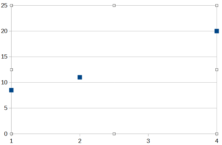

I don't know why lilford & Kodak never published times for 1+2, that goes for other developers that can be use FS, 1+1, & 1+3, Perceptol, Microphen, Xtol, etc.
The easiest way to determine an initial time for 1+2 is to plot a graph and interpolate, it's a slight curve not a straight line but quick and easy. Back in the 1980s I would use graph paper, these days a spread heet (line graph).
FP4 in ID-11 @ 100/22 EI 1 = FS, 2 = 1+1, 4 = 1+3, so on that basis 1+2 (3) would be around 14.5 to 15 mins.
