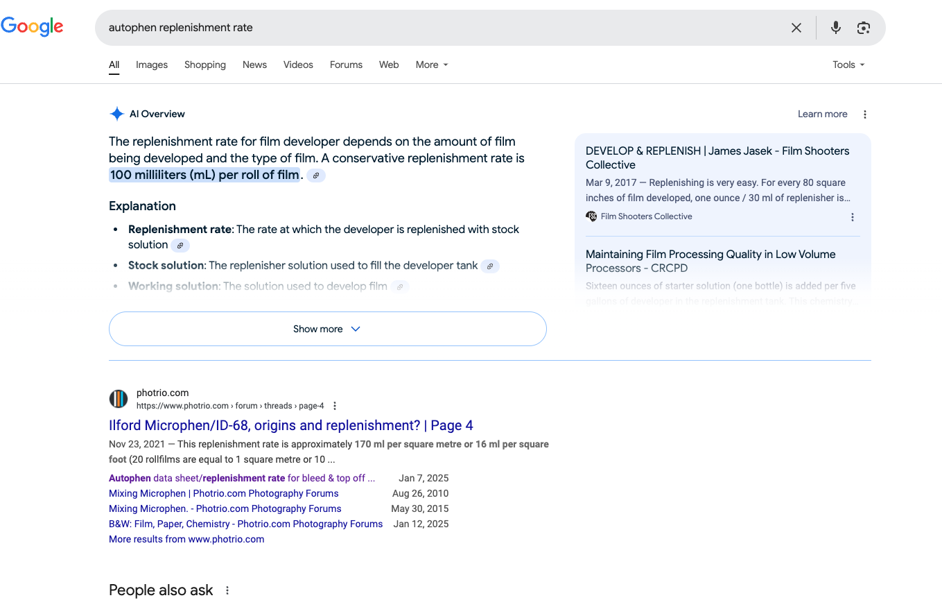

is the attached photo the same result you have from google?
also I'd also love to know the replenishment for id-68 since I use that quite a lot as well. if you happen to know please lmk - but I haven't googled it yet so it's prob right in my face.
Nope; Google has a habit of tailoring search results to the situation. So you see something different from what I see, and this even changes all the time, to boot. The idea is that you use Google to locate relevant sources and then start reading.
