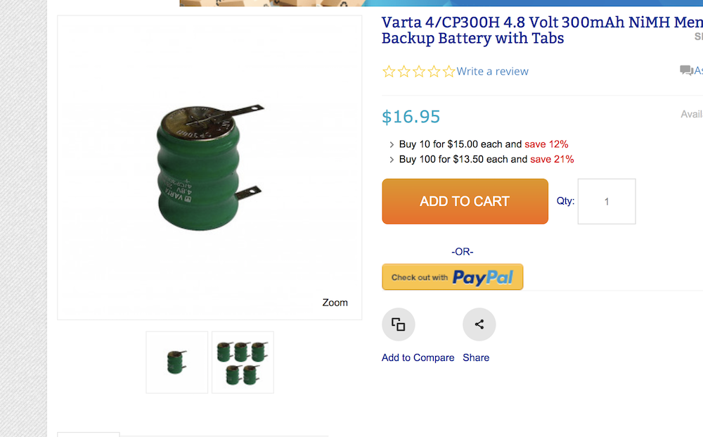

Wonder if he ever got this repaired. Lost in the thread is a link I posted above to what looks like a drop in replacement. This was a surprise to me because last time I searched for those Varta button cells for my Rollei E36RE, I thought they were out of production. Looks like this place can make a stack of them any size.
AgX
Apr 5, 2007
29,968
Germany
This is a battery made of NiMH cells in series.
The OP though is looking for something like this, but from NiCd cells. Or loose NiCd cells of apt dimension, wtih tabs, to solder them in series. (Alternatively he could re-use the original mounting caps, or otherwise fix the stack. Just fixing and contacting a stack by means of shrink-hose seems daring to me.)

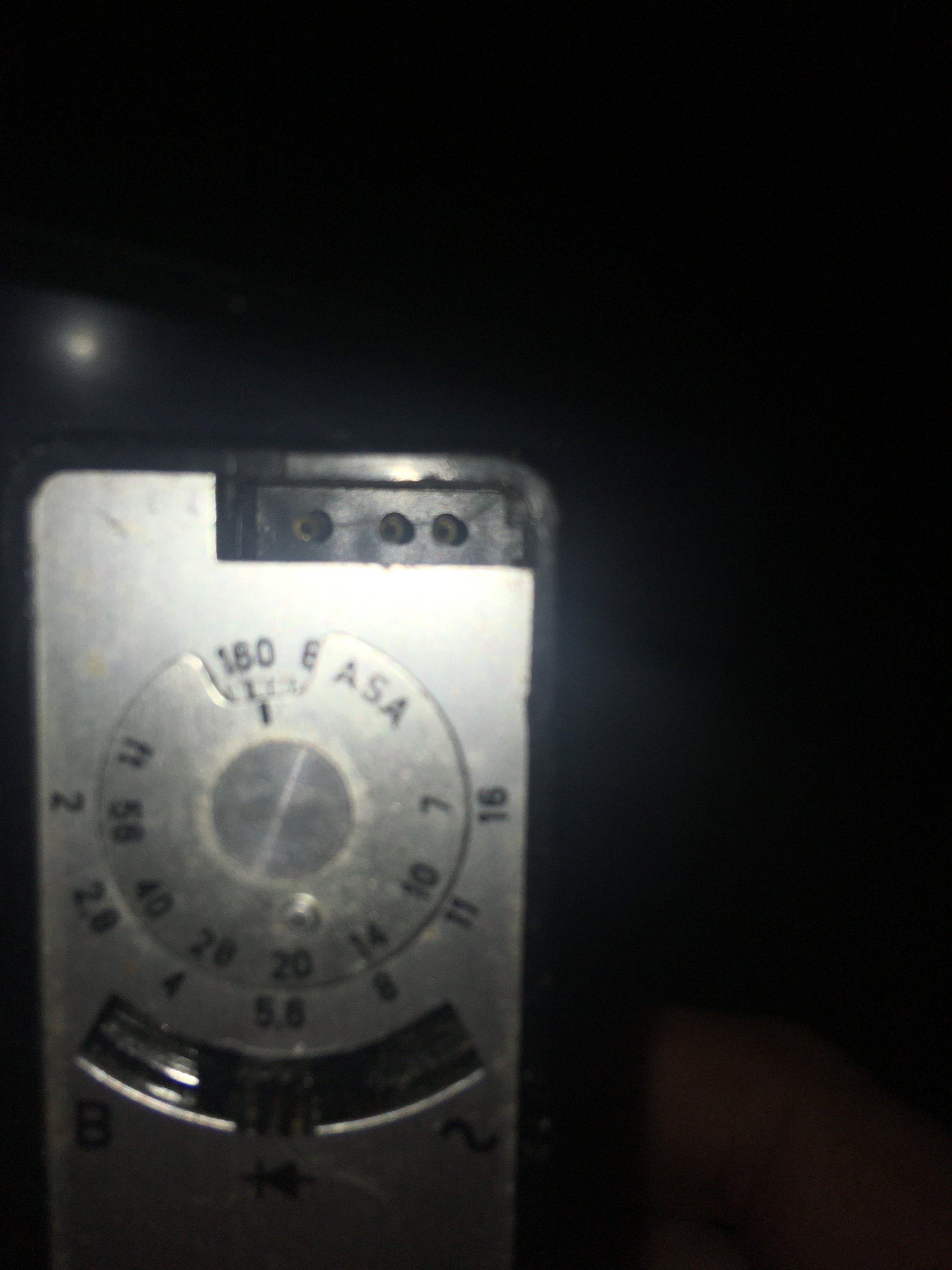

I have been busy with work, but have tried researching what I would need to charge the NiMh cells, like the ones shown above. The Bauer charger has three small female connectors to the three pins on the flash but doesn't have any listing of charging voltage or wattage. If the flash isn't usable as it is, I suppose the worst I could do is blow it up!
The "charger" not only is a charger but also a mains supply. Typically such devices supply 2 voltages, thus is 3-pole.

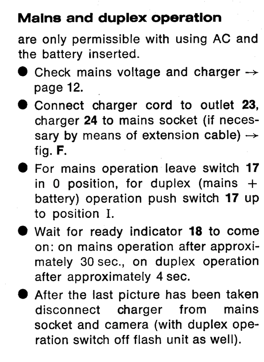

Agree with AgX on that. The Rollei charger is similar. Its three-prong plug provides the slow trickle charge for the battery and allows "Duplex" operation for charging of the flash capacitor (from mains current) while the battery is charging.

Yes, the flash has a separate position for direct mains operation, and is working fine that way. I'm thinking that this is a good thing, right? The cells should arrive midweek, so I'll probably attempt the installation next weekend. Thanks to you and AgX for your advice. I'm far from an electronics whiz.
The OP's model even has a 4-pole connector.

Only three poles... Two are closely set, the third is further from the two on the right. I posted a photo a few posts up.

Yes, but a model from same range got already a 4th pole in that space. (I mixed up models and tried before to edit my post above but the system failed.)

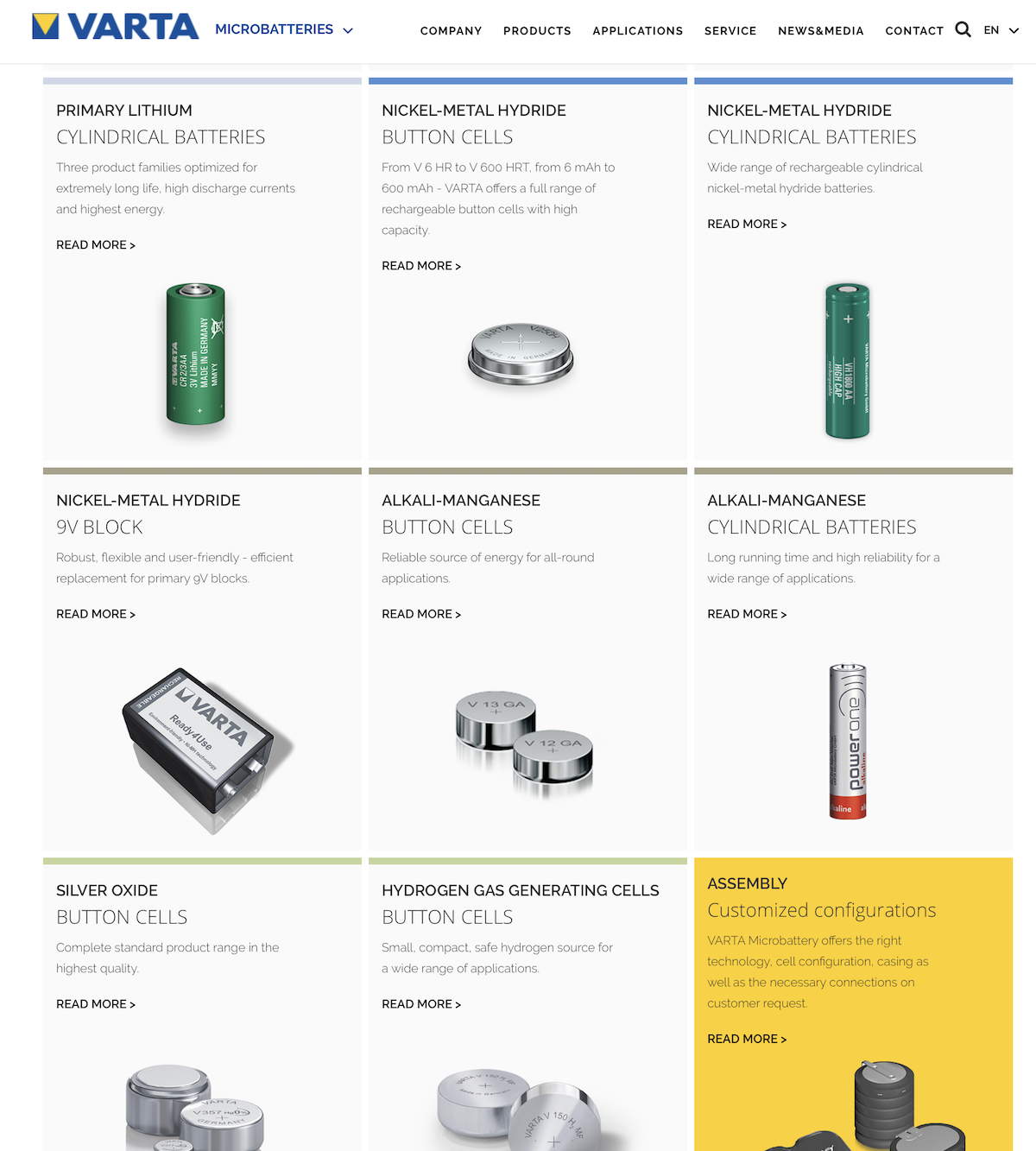

Again, I don't think Varta makes the button cells in NiCad. Not sure why people are suggesting they are still available (but I may be wrong). Any links?
