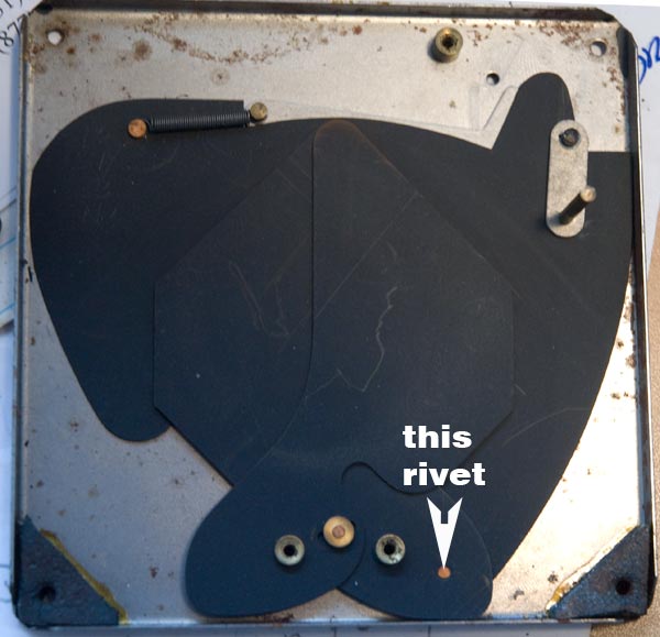

I have a packard shutter that I recently acquired that needs to have one of the small shutter blade rivets replaced. It appears that this may have been a previous repair that was installed too tightly.
Any ideas on where I might be able to get one of these? I have already tried smallparts.com and they only have solid rivets this small, no tubular rivets.
I attached a photo of one of my other packards to show the rivet.
TIA
Rob

Not exactly certain, but it appears to be about 1/16" in diameter. When I measured the combined thickness the shutter blades it was 1/16", so it needs a grip length of a bit more than that.
When I searched the web last night, I found quite a few wholesale type sites, but no retail. McMaster had solid copper rivets 1/16" diameter, but that may be difficult for me to install.

Fixed it!!!
I was able to gently pry the squashed edge of the rivet up. I used a piece of sheet metal to protect the blades & held the pin down with a small screw driver. Worked my way around rivet several times with my pocket knife. Then I pressed down the blades from the opposite side with a small fender washer, rivet in the middle. That gave the one blade enough room to move freely. Works like a champ.
Thanks for all the suggestions.
