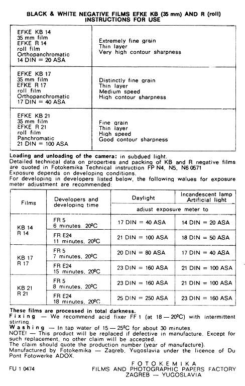

Here's an early EFKE data-sheet for the films which were bay then made under license from Dupont who had ben the last owners of Adox. Note the tungsten (incandescent light) DIN used in each films name.
