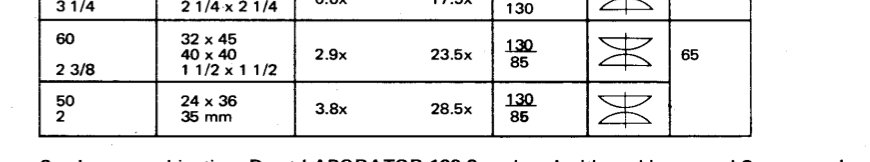

If the length is really 120mm, then the globe is might not even be the 65mm minimum globe diameter (far right column) so it would likely only be good for small format enlargements. For $8, I'd try it and see.

Diameter of that bulb in question is 65mm.

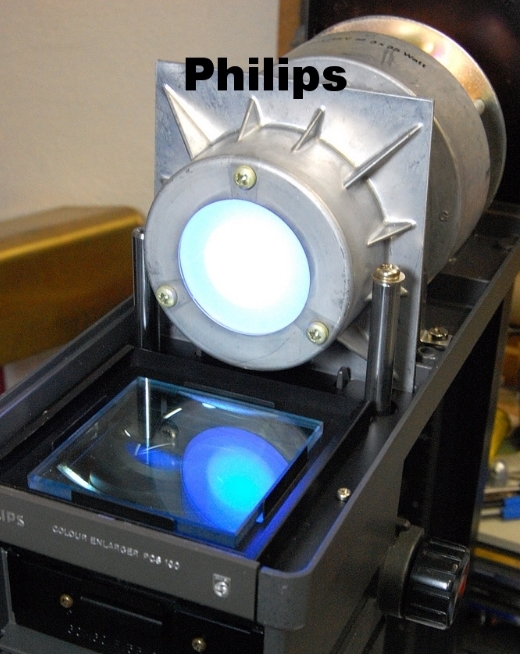

I had a condenser head I'd replace the lamp with a opal disk and shine a halogen lamp or whatever lamp I wanted on the disk form behind...wait...I have a condenser enlarger and that is exactly what I have done...
