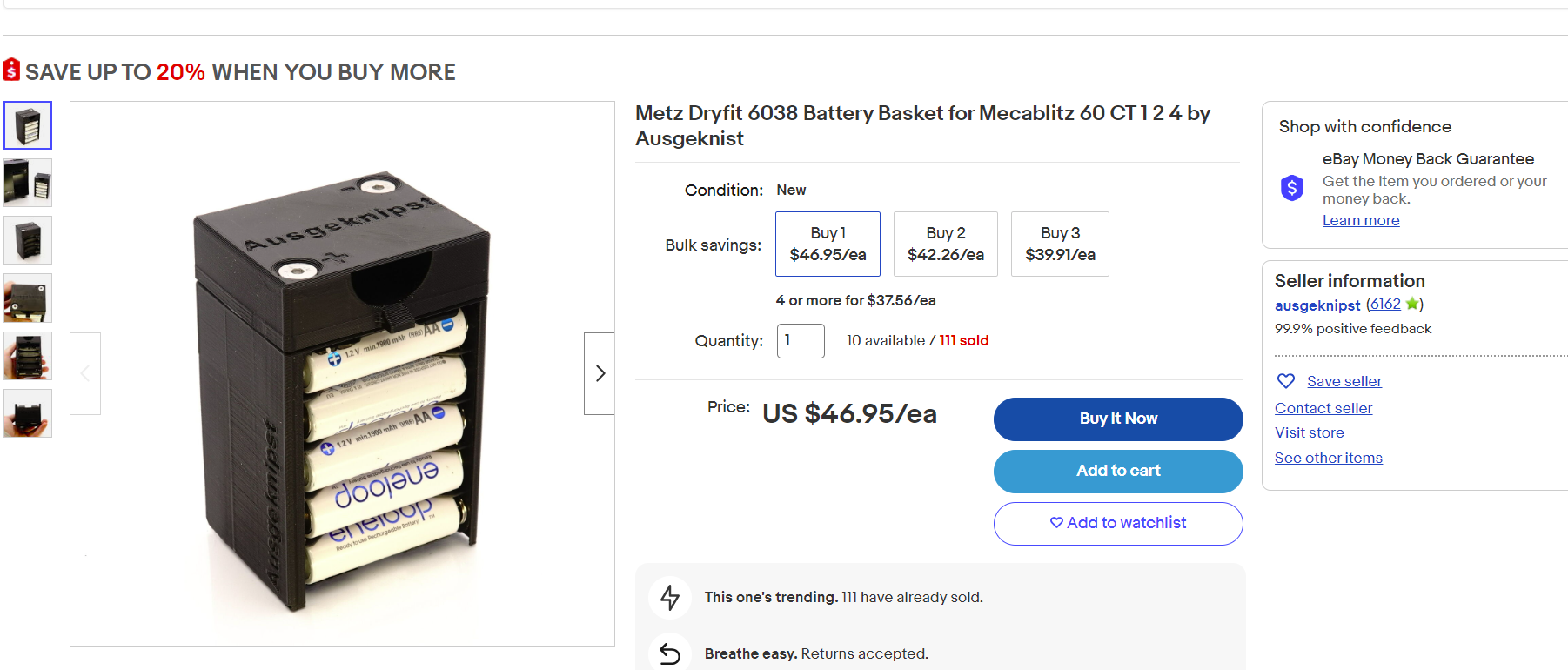

I have seen another seller selling a kit on ebay, when which is also 3D print but need assembly. Perhaps you can take a look ?

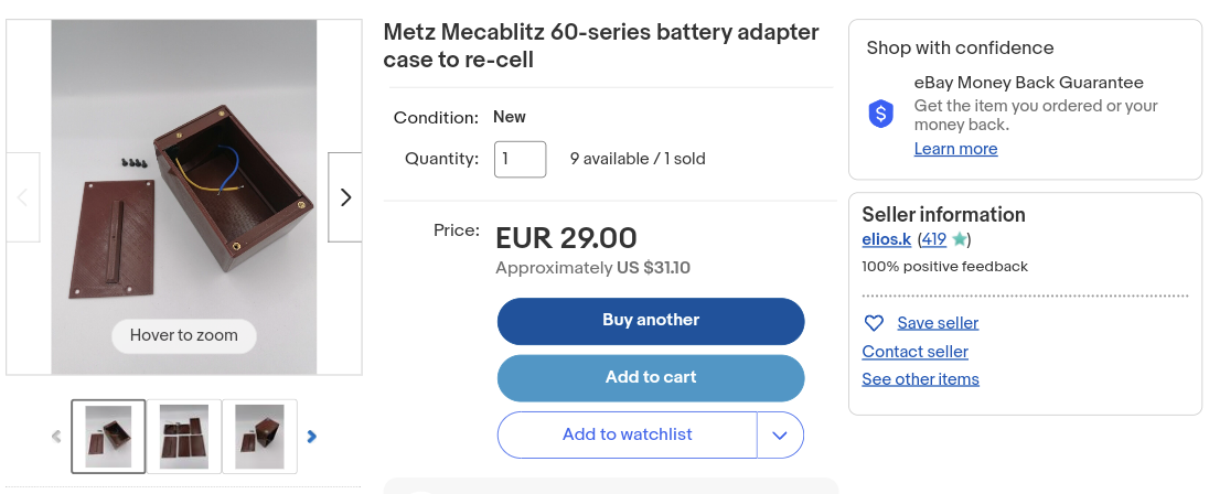

I didn't buy the box from the guy. This is his Ebay listing. He made it to be used with 10 AA NiMH but I asked him if he could make one without the battery holder
The batteries last quite well. The only problem is that I have to remove them to charge because the charger that came with the flash won't charge them well.
