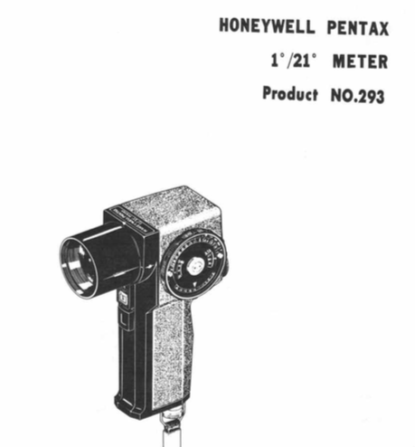

I have a lot of service manuals. I'm not on my computer right now but I"m pretty sure I have that one too. I'll send it to you.
screen-shot-2019-08-17-at-8-13-36-am-png.229066
Wow, you're a very helpful person! Thanks!
That image, though, may not be the right version -- mine has a small white button in the ring on the (user's) left side of the grip that turns the dial light on when pushed.
