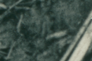

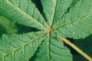

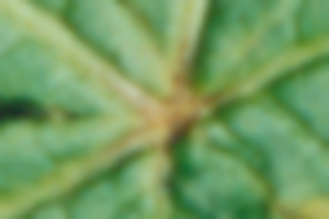

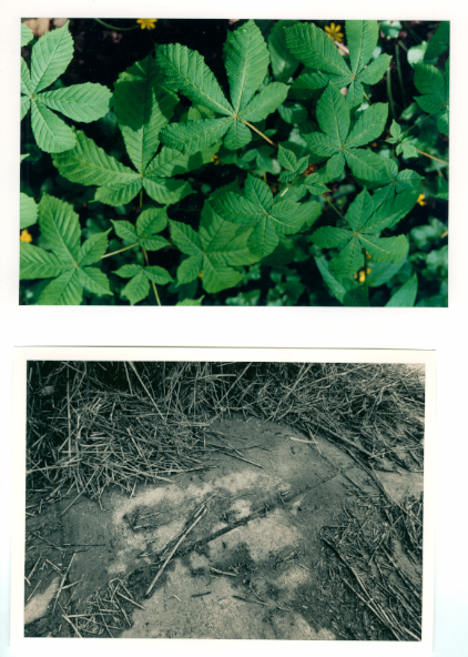

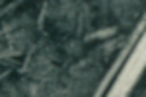

Let's take two snapshots from a stack here in my darkroom, one color and one B&W, both RC paper. Both taken with 35mm consumer grade lenses and decently done, but nothing stellar; i.e. no 4x5" Symmar-S contact print or anything. So fairly typical of what OP is probably scanning at this moment. Here's an overview:
This is a 300dpi snippet of both, taken from areas of the image that seem to be advantageous in terms of 'fine' detail:
This is a 1200dpi snippet from the same general areas:
Now compare this to similar snippets taken from the 300dpi scan, but sampled up to fake 1200dpi:
The net gain in real detail is very limited. There is some, I agree, especially in the B&W print, but how meaningful is it to adjust a workflow based on the marginal gains?
