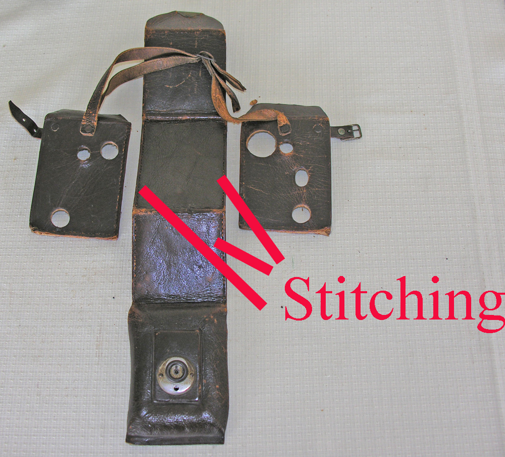

I have a leather camera case [not an ever-ready case] for an eighty year old medium format camera.

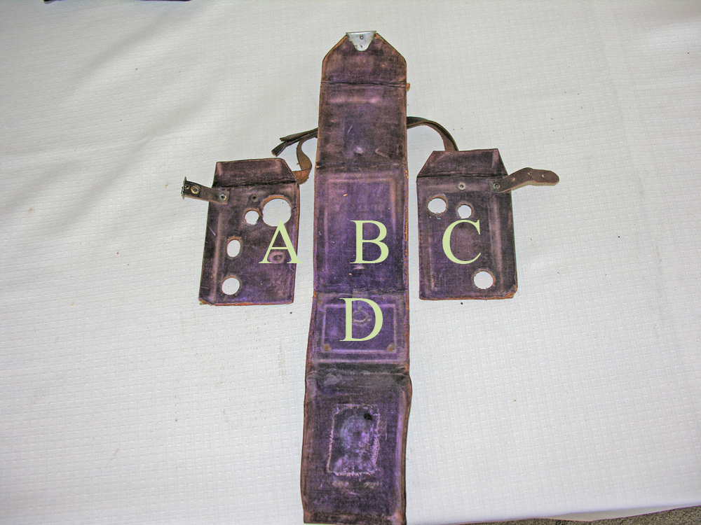

However the case has come apart – as shown in images case01 and case02.
I’m puzzled as to how the case was assembled and thus how it can be repaired.
There is stitching on items/sections A, B, C and D – but items A and B appear to be butt attached to part C and possibly part D.

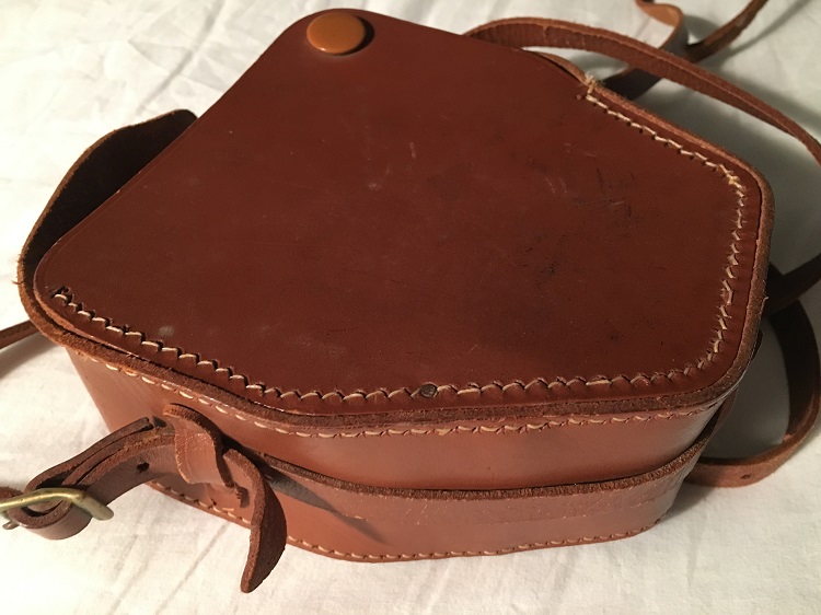

Other leather items I have (for instance image case03) have an external seam inside which the leather is folded at 90 degrees to form a ‘box’. Whereas this camera case shows no such seam and in spite of stitching holes I suspect that the parts are glued together to form the ‘box’ surrounding the camera body.

You are correct. They butt together. Parts A and C but against B and D and are stitched. This creates a partial box which covers the back, sides and bottom of the camera. The remaining two parts are flaps which snap together at the front of the camera.
If the leather isn't too dried out I expect any decent shoe repair shop could have that back together for you very easily.

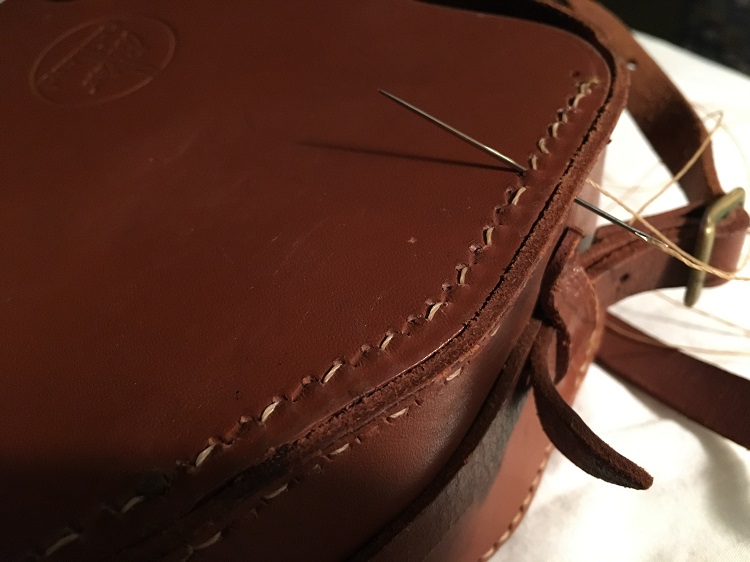

The DIY info you linked is good, the way I do it is a little different. Instead of using two needles and thread I make two passes. You can see in the photo below that I completed the first pass and now I'm coming back with the second pass. After the first pass it looks like you missed every other stitch. I've repaired a few cases this way. The second photo shows the finished work.
Kodachromeguy
Nov 3, 2016
2,053
Olympia, Washington
The 80-year-old camera is a Rolleiflex, right? Do not take it to a shoe repair place. Do exactly what BAC1967 demonstrated in the answer above. Use a medium-size needle with any good quality polyester thread and carefully push the needle through the existing holes after having aligned the leather pieces. You can't do this with a machine. Pull the thread tight but not super tight - you want the pieces to be able to flex a bit. Also, if the leather is old, it may be a bit brittle and pulling tight will cut through the leather. I have heard, but cannot confirm, that 100% nylon thread becomes a cutting tool, while polyester or poly/cotton is gentler on the leather. Using neatsfoot oil on old dry leather is good advice.
