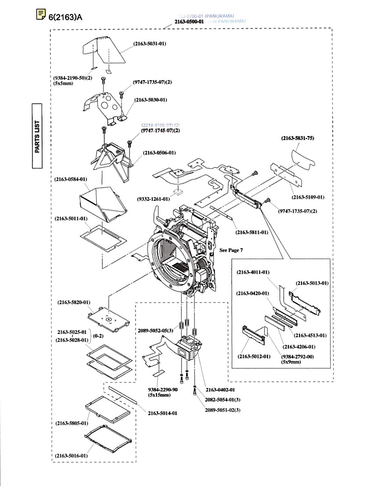

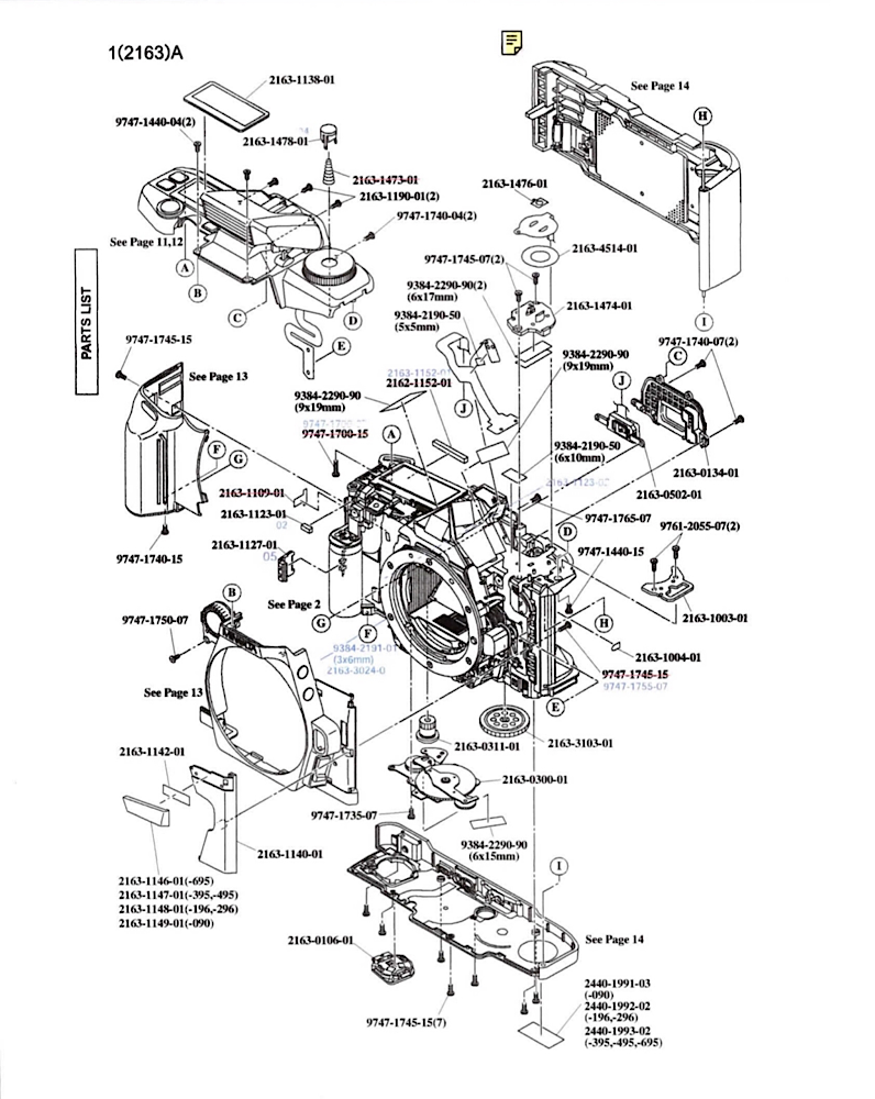

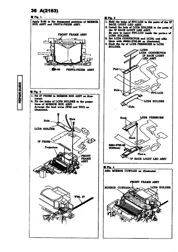

Here from the service manual for an overview of how the prism is installed:

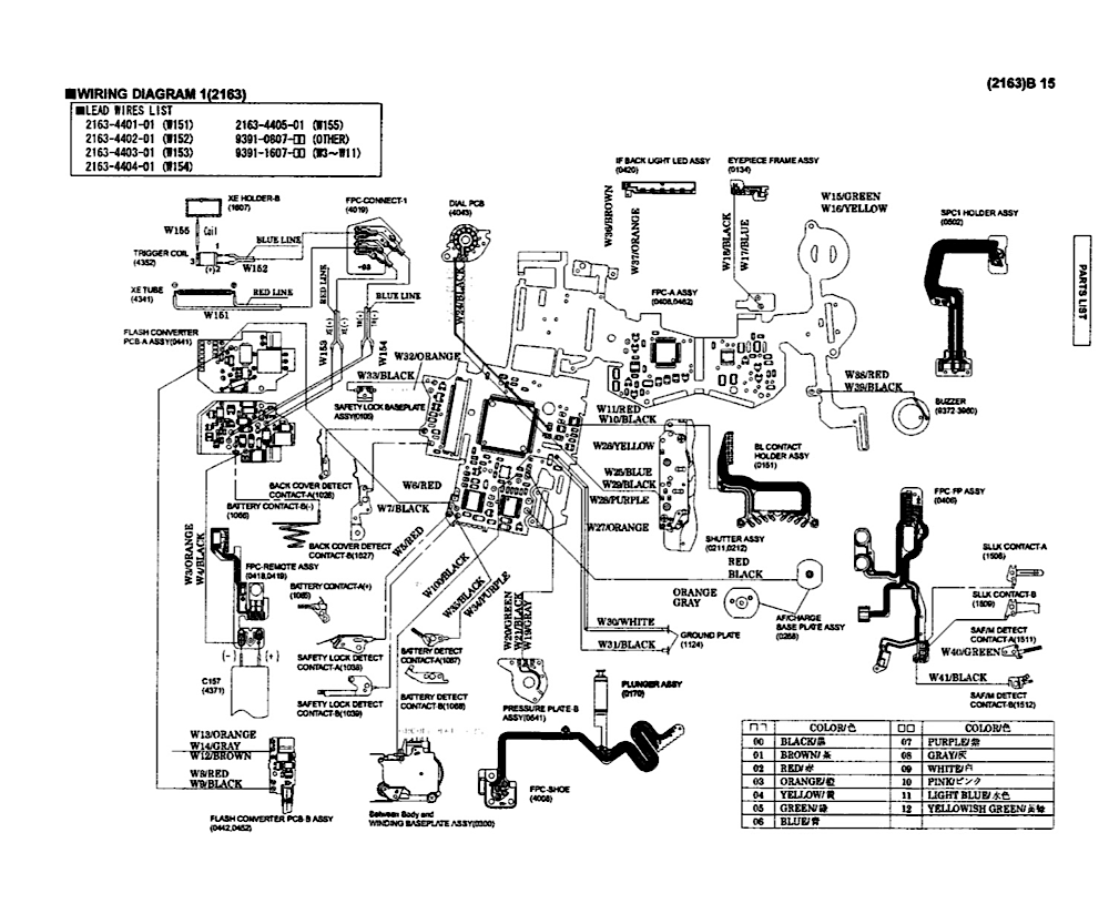

The layout of the flexible circuit board that lies over the prism and is expected to need to be removed in whole or in part:
I would start by dismantling the top cover (screws) and then see how the board is connected.
