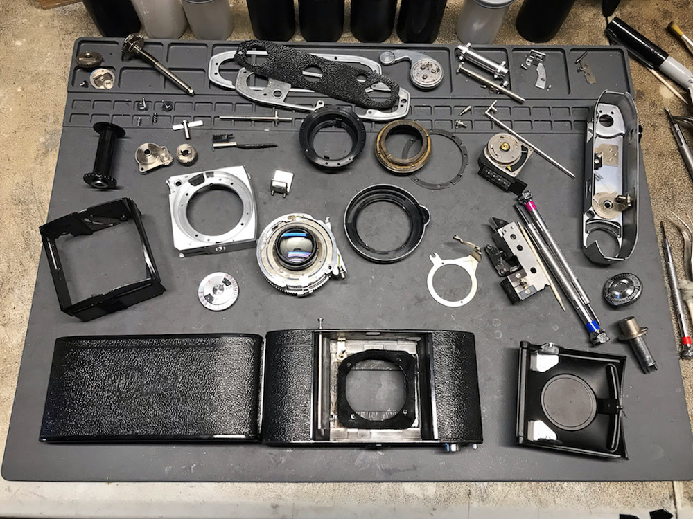

For those that know, how long would a full strip down of a camera and rebuild take? For example, in the UK people charge £150-200 for a CLA and rangefinder alignment for a Leica M. If that a CLA like that is a couple of hours work that is a pretty good earner. I suppose repairs can take a lot longer and you're not charging much more so it averages to more modest sums...?
When I service a Retina IIIc for example, the camera gets stripped completely down to its components, shutter included. Everything gets cleaned, what needs lubricating gets new lube, and reassembled. This model usually takes me 10-12 hours in total. That includes the extra hour or so I often spend addressing cosmetic issues like regluing leatherettes and removal of Zeiss bumps, etc. Cameras that need extra attention (fixing or replacing damaged parts, for example) can take up to 14 hours in total. I expect most complete servicing offered by others involves as many hours, assuming its a complete strip down and cleaning.
The earlier Retinas do not include a fancy rangefinder and shutter/film advance linkages, so those can take as little as 7 hours to service. The Retina II and IIa often take about 9-10 hours.
In this photo, the shutter has already been completed, so it is not shown in its disassembled state.
Thanks for that photo and explanation!
