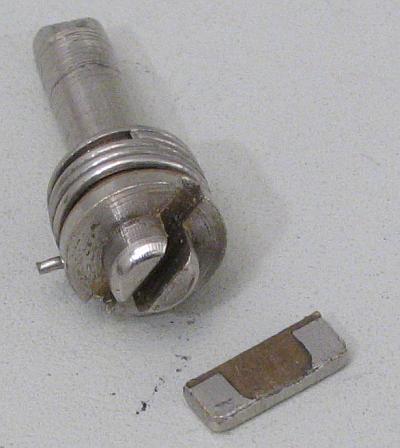

It's a little hard to tell but is there a slot in the part that protrudes?
If there is what about making a cross piece from a piece of aluminum or brass & expoxy it in place.

John is right about the Solida. I took the spindle out of my Solida 3. I expected the drive dog to be pinned to the spindle, but it turns out it is only held by friction - which is why yours is AWOL! See the picture below - the thickness of the brass strip is .058", so try to find a piece a little thicker and file it to size.

1/16" is .062"; 1.5mm is .059".
Not sure what the standard is where you are but over here 1.6mm is a standard thickness for sheet aluminium. That should be quite a good interference fit.
Steve.

That's great information, mine is a Franka Solida III as well.
One of my client's is a machinist and said he would machine the tab for me as a favour, as we have a really great relationship. ....basically, I have not lost him any money in his investments :wink:
Do I glue the part in, or is there a better way once the metal tab is ready?

For the Solida, if the metal strip is a tight fit you could rely on friction as Franka did in the first place, but for convenience, and to save taking the spindle out to press it in, you could get it made a slightly easier fit and secure it in place with Loctite - your machinist friend will probably have some or an equivalent.

You can just start by cutting a penny down to the right size and glue it in.
