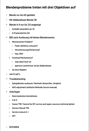

Currently, I'm dealing with a Canon T90 that only closes its aperture to f/8.
Reviewing the existing repair documentation suggests a mechanical problem.
Various observations, test results, and thoughts on the cause and solution of the problem need to be noted down before I forget them or get them mixed up.
The classic mind map is well suited for this; it's flexible, grouped, and provides an almost graphic overview.
Better than loose thoughts and illegible notes, at least for me.
What kind of organization do you use for more extensive repair projects?

Then I'll be the first person you'll meet who does it this way 😉
Look above at my mind map for a T90 problem.
The most important considerations are captured, and conclusions and actions are derived from them. Connections are marked with arrows.
This way, the initial problem analysis is documented in a structured format and can be adjusted later. This allows me to get to work without forgetting anything, with everything in a clear overview.
But it certainly also depends on whether you think visually or in writing.

Ah, now I understand what you mean.
It's not about planning a repair process in every detail; that wouldn't be possible anyway, since I don't have the necessary information.
The point here is to capture all the initially found information and considerations in a meaningful way. And a mind map is ideal for that.
The mind map for solving a Canon T90 aperture problem is complete.
By arranging and linking the branches, I was able to organize my thoughts and thus have a plan for how to approach the problem.
The outline view can be used as a checklist for checking off items.
