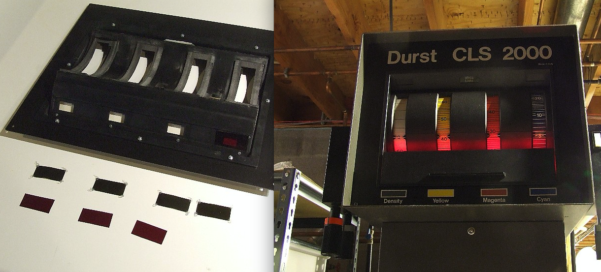

I used one of the Rosco 'primary red' colors to make "safe" lights for the filtration values on my enlarger. The inexpensive sheets work very well and were "safe" when I tested with Ilford MG paper.
