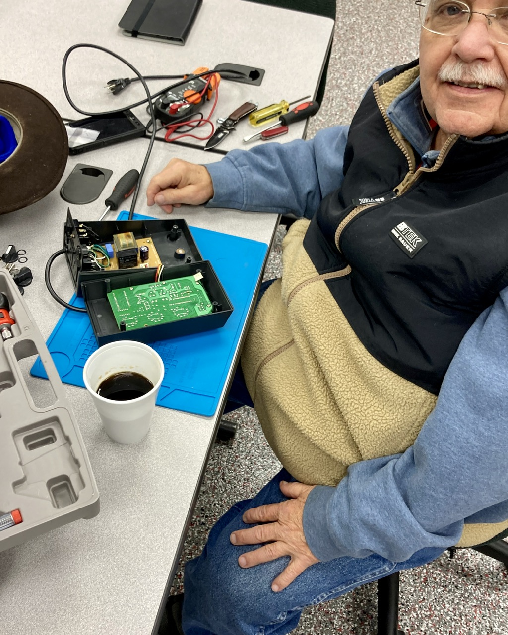

Korak provided the answer. Last night I attended an Amateur Radio (HAM) group meeting. A member was able to trouble shoot and repair a solder break.
We live in a throw-a-way society. An independent repair tech can’t make a living today. HAMs were often the kid who had to take things apart to see how they worked.

1. Electronic used timers are pricy for what they are and hard to find in good condition.
2. Good helpful people still live on this planet. 🙂
Excellent !
The cup of coffee, it says it all
