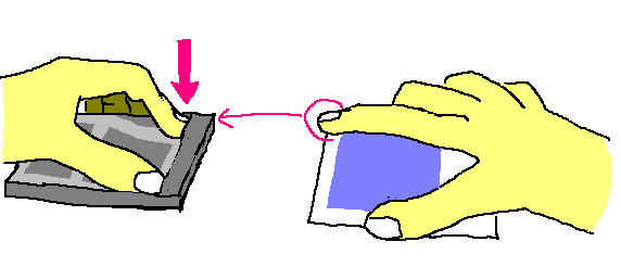

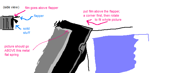

Took some time but now i finally tried it out. Turned all lights off in the apartment and hid in a wardrobe, the darkest "room" i could procure. It was by no means perfect, and after a while i could make out the dark of the actual film against the white border. At one point i turned around and there was a glow in the dark image my sister must've put there (we have a game of hiding this one in each others apartments, going for several years now).
I carried on anyway, because any damage would've already been done.
What i do is i hold the cartridge in a way where i can push down on the front of the metal spring, and the picture like i'm pointing to the upper corner. Then with my index finger i can feel the cartridge and guide the picture into the slit. You will need to push down the flat spring inside, or the picture will go underneath. When it's correctly inserted in the hole you can then slide it in by pressing lightly on the sides. When it feels like it's securely in place, be careful that it hasn't in fact stopped like 4-5 mm short of the back wall (you can still feel it a little through the slit). This is due to the flat spring again. You will need to somehow arc it upwards in the middle (by pressing inward from the sides), or at least keep it very flat, then slide it back and forth a little. Eventually it should go in there. This usually happens with the first slide, shouldn't be a problem with forthcoming pictures. Also, after every picture inserted, check that the black flap hasn't been jammed in there as well (it wants to go in with the pictures but it should stay outside). If this happens i usually try to get hold of a corner and pull outward. I'm pretty rough with it though, and it feels like it can be torn off easily, but so far it hasn't.
Also be careful if you like me do this in the dark (well, "dark") not to put the pictures in upside down. I believe you can feel in the pod area which way is down, but still, keep this in mind.
Here's some shitty mspaint diagrams:
Then advance with thumbs at side of picture (light pressure):
