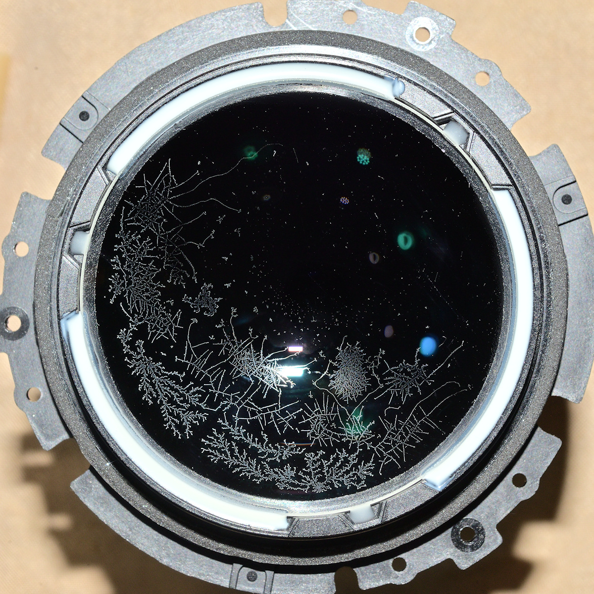

unfortunately it is a common problem that the front lens of the SONY RX10 fogs up from the inside, between the individual lenses, and then after a while becomes moldy because the bonding of the two lenses in the plastic frame is not completely tight.

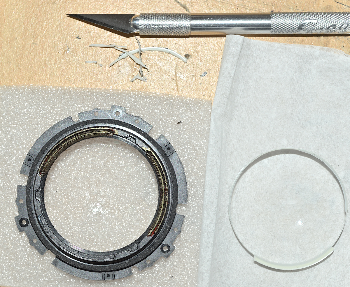

So I had to cut the rear lens out of the frame:

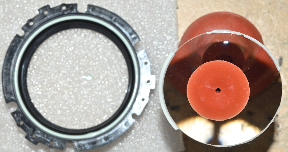

Clean everything thoroughly:

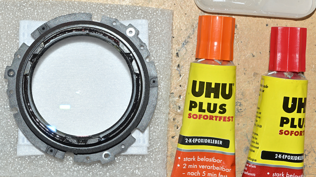

Glue the lens back in:

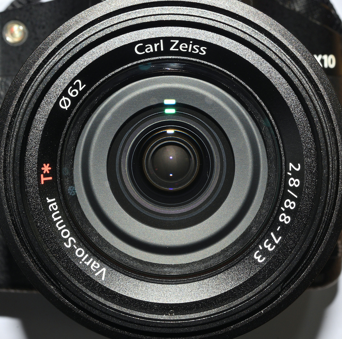

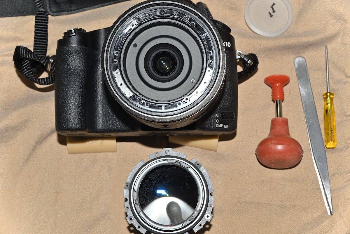

And after a day of drying time, reinsert the front lens:

Did you do anything specific to get the lens to sit in its mount properly? Did it simply index back into place smoothly? Getting a lens element crooked always worries me.
Since I have no way to optically center a set of lenses, I reinstall a lens in exactly the same position as I removed it.
As you can see in the photos, I leave one of the seals uncut and mark the other two joints in the frame with a red felt-tip pen.
How did you clean the fungus so thoroughly?
I love your post! I just purchased an old RX10 inexpensively due to fungus. Your post is great! I do have two questions though:
1. Why did you remove the back lens instead of the front lens? It seems as though the back lens has some retainer tabs that the front lens doesn't have.
2. How did you apply glue to the lens when you replaced it?
I'm surprised that a case of fungus that severe does not seem to have etched the lens coating -- assuming that it is coated.
Because the front lens is pressed firmly into the plastic housing. To cut it out is much more work and to get it in after the cleaning difficult. And getting this dense against moisture ist complicated.
With a thin spatula.
Did you leave this seal on the lens when you remounted it? And just glued it back using the 2 remaining joint?
And "epoxy"; that's for eternity! Wouldn't a soft glue be better. Like the ones used to glue a handy.
