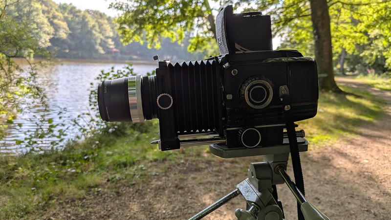

Hi,
To add to the Bronica discussion, I own this Bronica S2a with a bellows extension, two extension tubes and a custom-made adapter to mount a Rodenstock Imagon. It's pretty usable and "cheap" as the adapter was easy to do (done by Optomeca).

Thanks you for all the input. In the end I bought myself an Bronica S2a and tilt/shift bellows.
