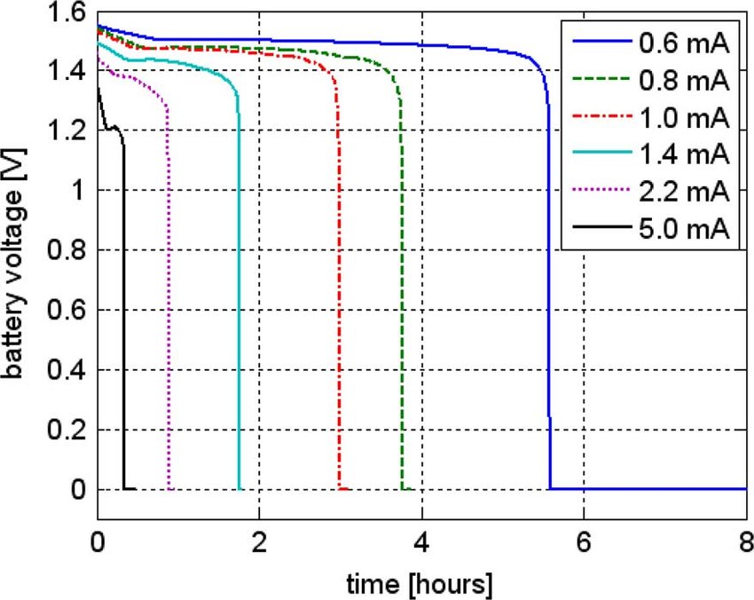

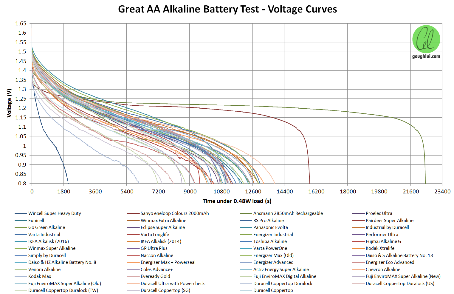

Let's take this alkaline battery discharge graph as an example
And compare it to this silver oxide battery graph
At very low draw silver oxide batteries provide ridiculously stable power that drops abruptly. But alkalines go downhill in unison except a couple snowflakes out there in AA form and even these: the jump from full to 1/3 and half is a roller coaster. With old cameras and meters with no voltage regulators your metering will be all over the place.
By now it should be obvious why my exposures were shit with alkalines and consistently great with "expensive" silver oxide batteries. The thing is - the latitude of negative films will mask these reading errors quite well, but with slides a stop and even half a stop difference can make or break a shot.

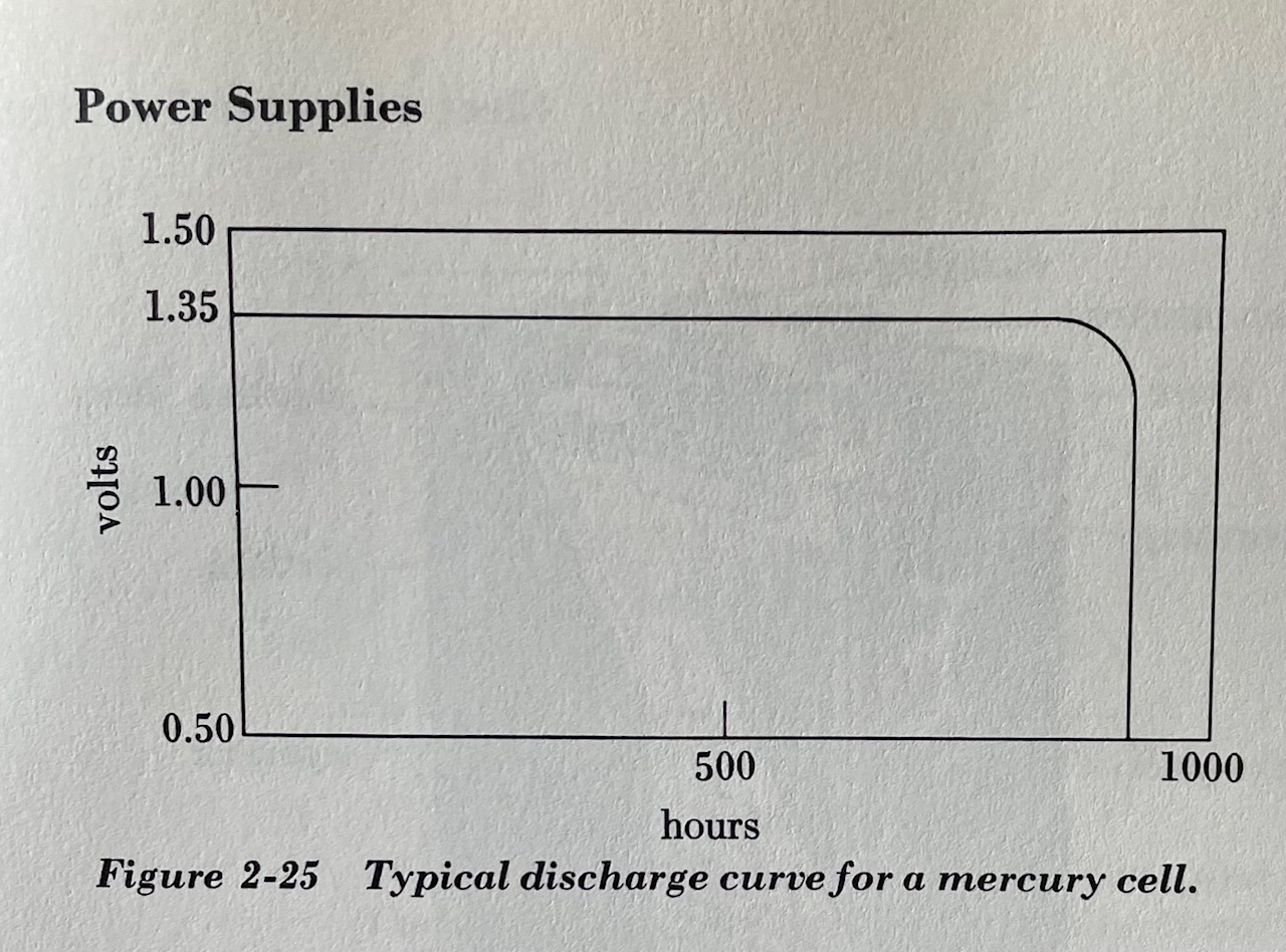

This is what the meters were designed for: A scientifically reliable 1.35 volts.

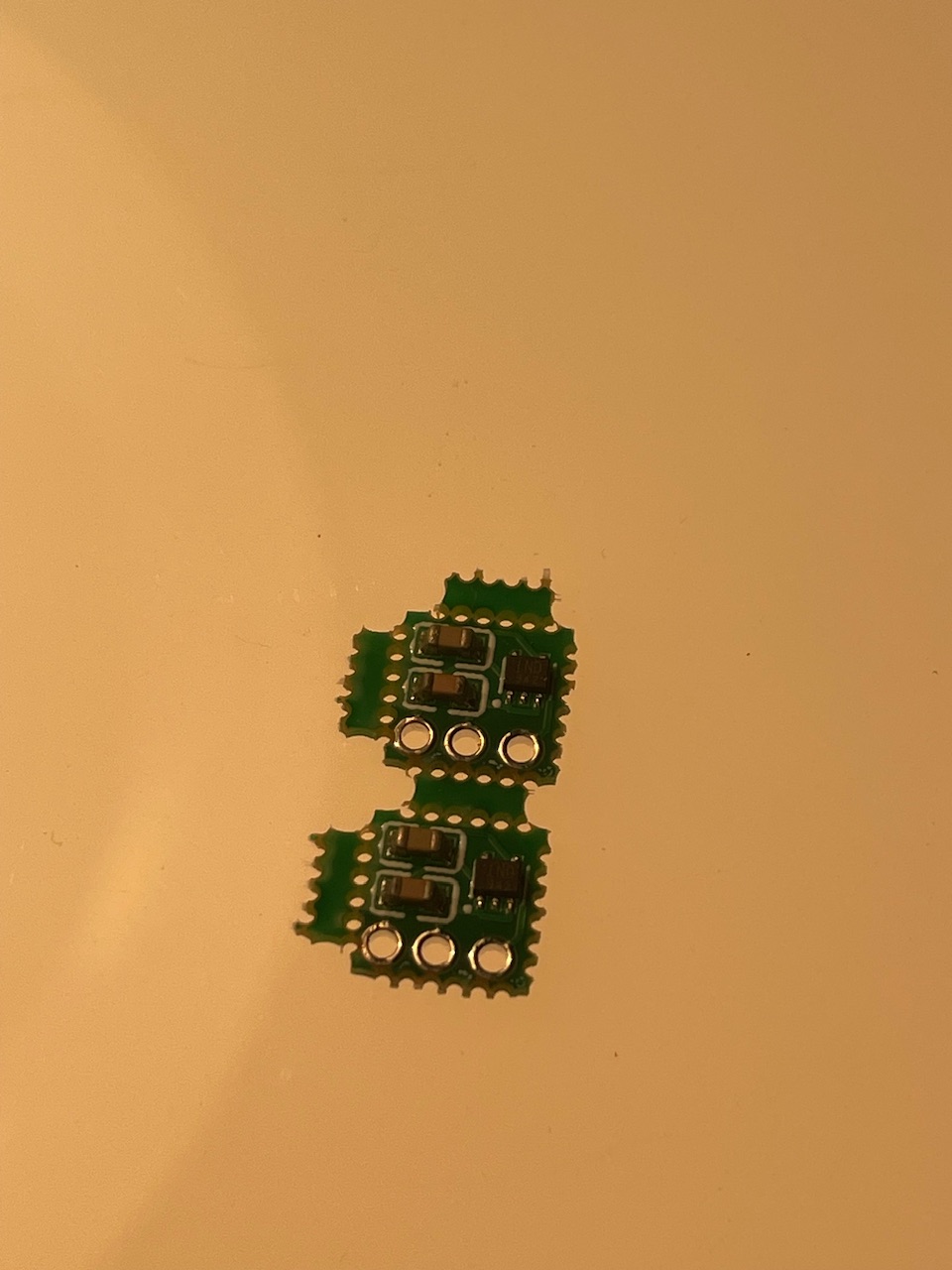

I am enjoying voltage regulators
Next level adapter would be voltage dropping + regulating :smile:
Such a thing exists and that’s what makes me so excited. But I only have two of each remaining (1.35v and 2.7v) and that feels like when you’re almost out of your favorite paper.
Now to shrink this to battery adapter size so no disassembly and battery fitting involved, and I'd pay some money for that.
PCBs like this need some extra modification. If you feed it directly by the battery, quiescent current will slowly drain it, so you need to put it after the on-off switch.
Right. So if/when silver cells won't provide stable output any more, I'll install this PCB
Right, I had a devil of a time putting in an additional switch for a Gossen Luna Pro. I mechanically linked it to the arm that releases the needle lock, because there’s three different power switches on that gray meter… but all three activate the arm. It’s very nice having the battery check hit the red zone and stay there through the life of the batteries.
