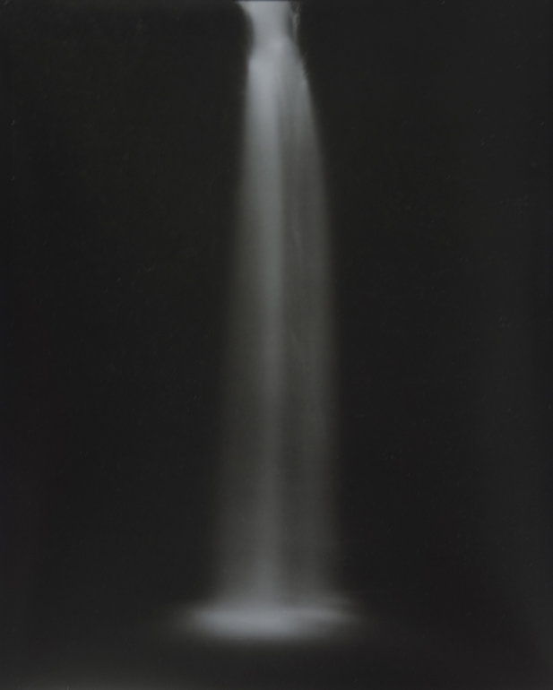

Any old paper I can get a hold of! Some of them really look beautiful. I made some 11x14 contacts onto some Kodak Ektalure (sp?) Surface K. 16x20 cut down to 12x15 with the remainder used as test strips. But I have a couple more sheets and that is all I can count on! Bummer, but I have some others to play with!
Horsetail Falls, Oregon
11x14 negative on Ektalure
