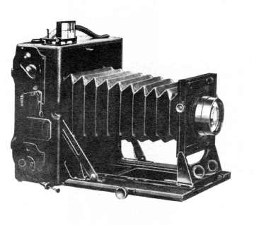

Probably on the longer side of that range. Diagonal of the film is 162mm. Here's the front cover of the "manual" - the text itself is not very informative. I just remembered that I have an old McKeown's (1992) - he says it's a barrel lens (but no further specifics).

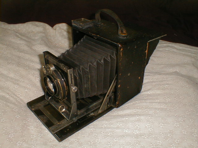

Aw that picture looks like my 1912(ish) top handle speedgraphic but it's a 4x5 so I can't really help you with an appropriate lens size for your format.
Maybe you should ask the people over on graflex.org's message board. they're very smart and helped me ID my camera.

I'd hope so since that's the manual for that era of Speed (I think 1912-1927, which is when the pre-Anniversary models came in) and otherwise I didn't buy what I thought I did (see photo). :wink:
Can you tell me what lens is on yours? At least it might put me in the ballpark. As of right now, my best option in my collection is a 160mm-ish f7.7Kodak Anastigmat in Diomatic shutter, but it's probably a good 15-20 years newer than the camera. Otherwise it's the RR off a No1 Film/Plate Premo. I'd really like to make it look as original as possible.

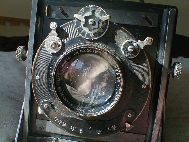

"4x5 Bausch & Lomb-Zeiss Tessar Series 1c. Pat. Feb 25, 1903" is what my lens says. What that means is it's approximately 130mm :smile: At least by my estimate at measuring.
a "willysmb" on graflex.org said
"The B&L Tessar Ic was one lens poposed in the original configuration. but in Barrel (I have a Press 5x7 with the same configuration 5x8 lens + ACME)
Since the ACME adaptation come later "
So maybe that'll help a bit. I guess they weren't too keen on confusing people with focal lengths in press cams back then, since they were suppose to be more or less point & shoot with a little distance range on the baseboard.
