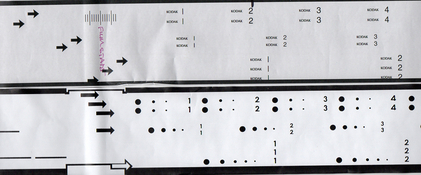

Here are Kodak Portra 160 and Fujicolor backing papers.

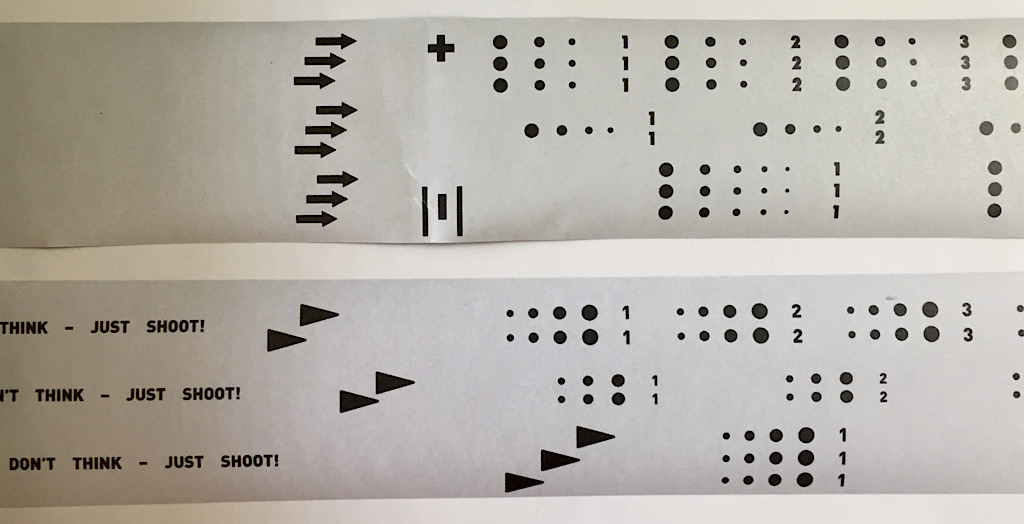

Following on from EarlJam here are Fomapan 200 (top) and Lomography Color Negative 100 (bottom).
