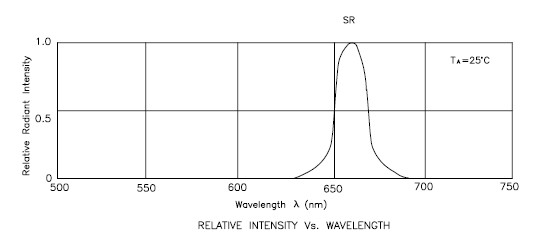

Glad you happened by, Brendan, given your background. Can you what the wavelength is of the normal red safelight in a darkroom. If it is 670nm then my next question is irrelevant but if it is not 670 then how relevant is a red safelight to the improvement mentioned in the study?
Thanks
pentaxuser
My darkroom LEDs are "peak wavelength" 660nm, very red. I chose them because I had some trouble with safelight fogging with LEDs that were orange/red. Attached is an exceprt from the spec sheet. I can have these at a bright level without fogging (tested).
660 nm is also thought to be a good wavelength. We use 670 nm LED arrays at 50 mW/cm2. This is bright enough to dazzle you, and exposures are ~15 min. Darkroom light is probably far to dim for an immediate effect. The key, though, is total energy delivered, or power x time. So a 15 exposure should be equivalent to 150 min at 5 mW/cm2, or 1500 min at 0.5. The bottom line, is that the red light can't hurt you, and MIGHT be beneficial.

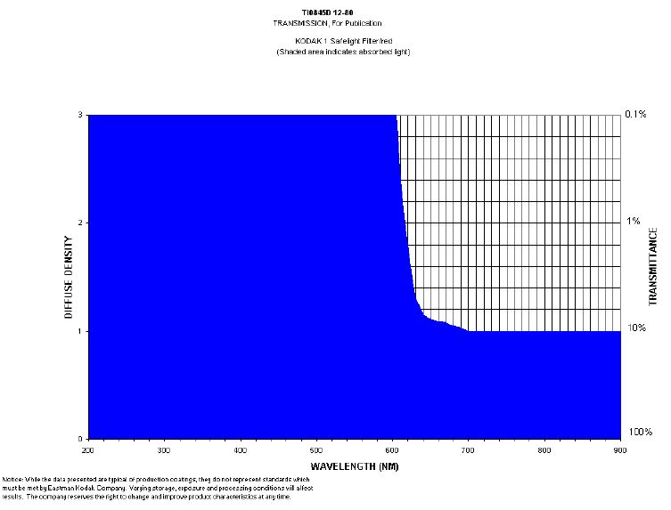

Thanks We are dealing with LEDs here but many, possibly still the majority, still have incandescents behind a red filter such as Ilford Kodak or Paterson red safelights What are these tungsten lights rated at ?
Thanks
pentaxuser
Here's the transmission spectrum for the Kodak #1 safelight filter. The 1A is the same as far as cut off, but transmits more light overall.
