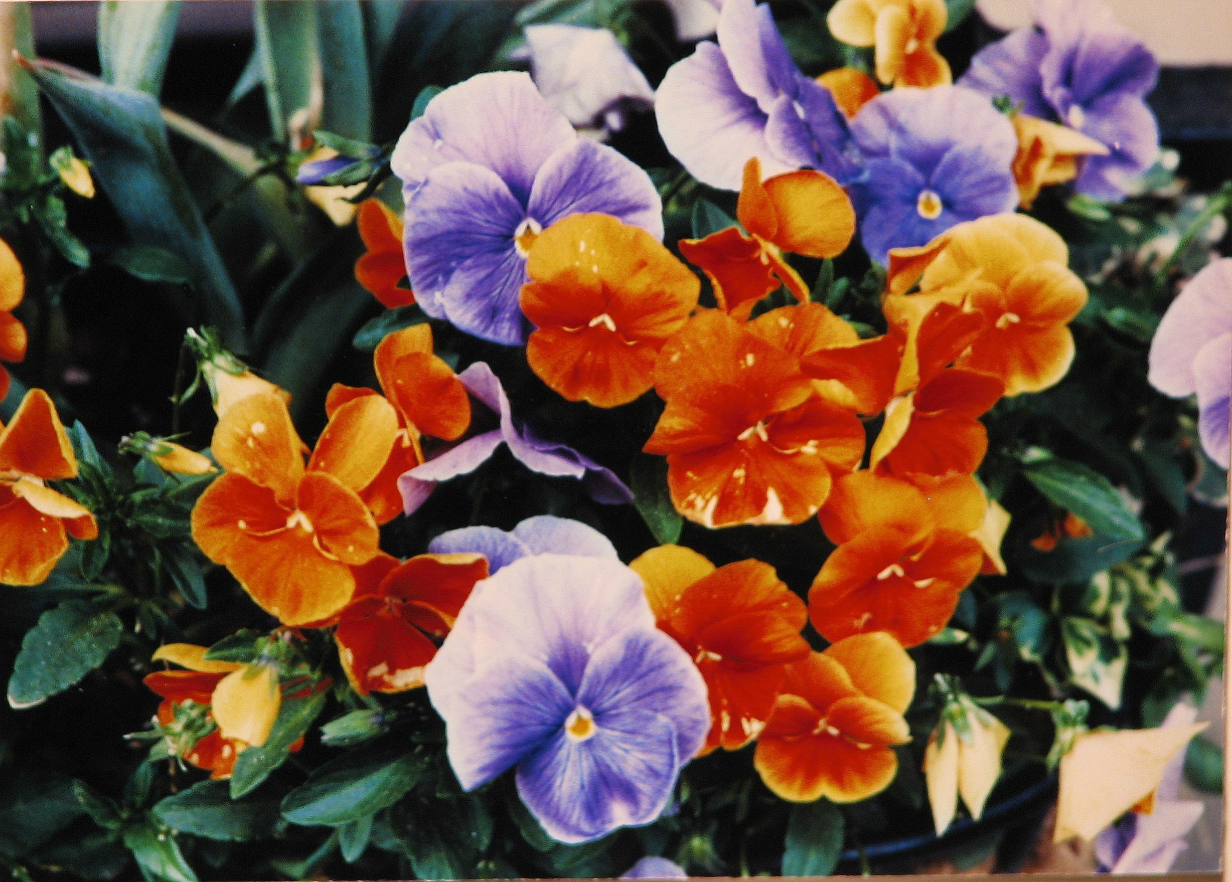

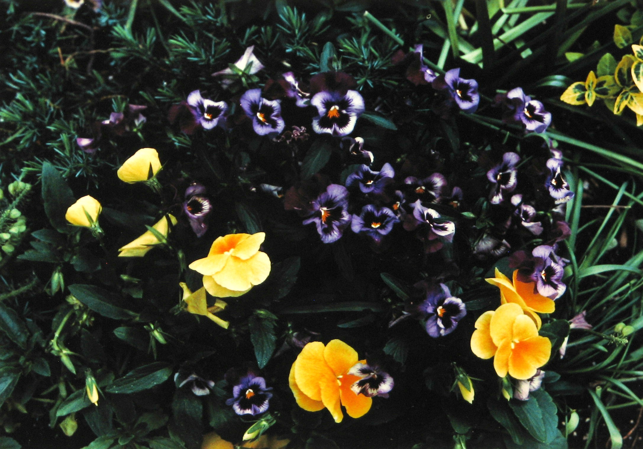

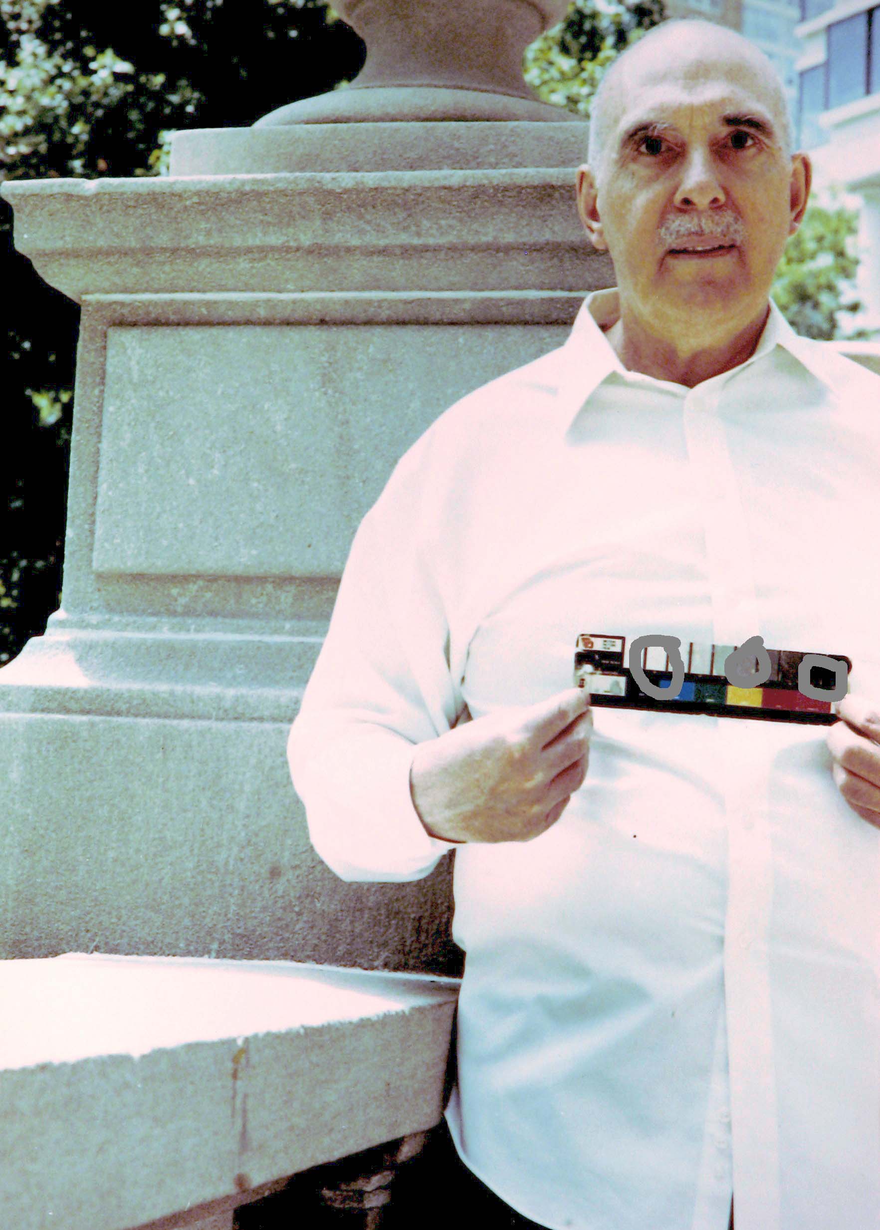

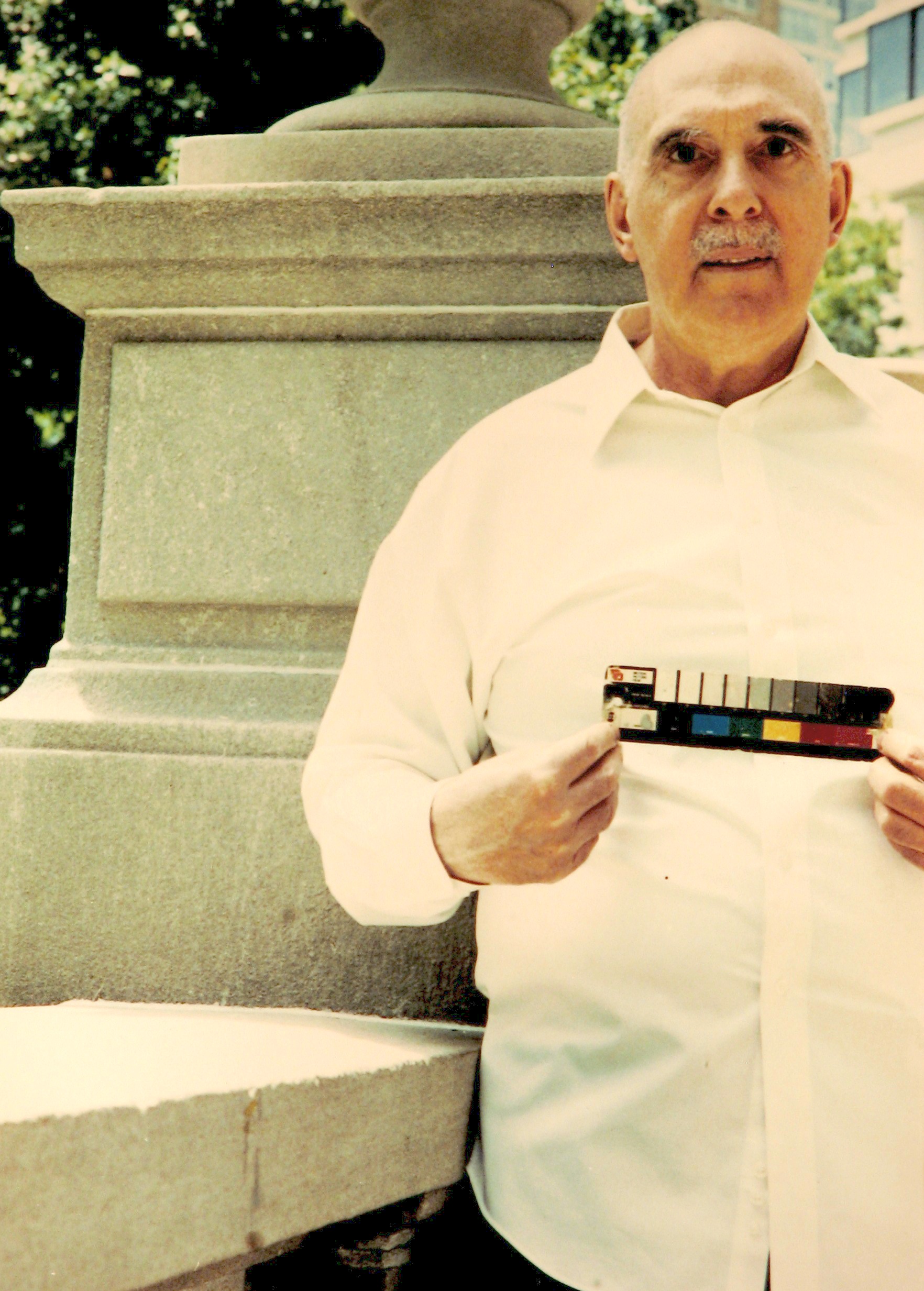

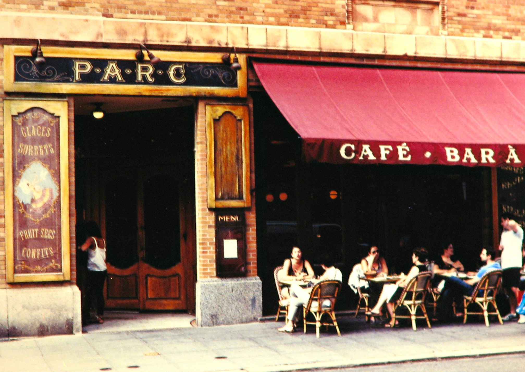

OK, here are my results.
C-41 developer: Kodak Flexicolor Developer.
My working solution is 1 + 9 with 2 ml of sodium carbonate, mono, added to each liter of working solution. Yes, this means that a ‘25 gallon size’ will make 250 gallons of working solution!
Temp: 80 F. Time: 15 minutes with frequent agitation.
I took these photos over the weekend. The film used was Fuji Super G+, ISO 100. The picture with me and the color swash was taken in Rittenhouse Square where there is a lot of greenery possibly to influence the tonal rendition of the (rather neutral) cement. - David Lyga

Took your image and read it .. here are the results from image of you with macbeth checker.
White shirt ( I assume it is) 3magenta 20 yellow
Cement 5 green 26 yellow
third nuetral check point 3 magenta 17 yellow
Basically over all you are about 15 -25 points off balanced colour

Yes, i can see the color is very off, it is evident to the eye!!
Still, i guess it would be easy to balance in the digital domain.

High crossover in the chart and his skin tone-I would say this would be very difficult if not impossible to correct in the digital domain.

Good work, David! Hopefully folks will believe us now when we say you can't get correct color balance from low temperature C-41 processing...
Digital does not solve all color balance problems.

three points on colour checker balanced to neutral within 1 pt.

David- I balanced on the step wedge to within 1 pt on three steps- highlight mid and low.
you are seeing obvious cross over.... you could upload to me the original file and I will balance for that giving a more fair appraisal.
The shirt is buff in color, not pure white. - David Lyga

You are correct, the color of me is not perfect. But the color with the purple and yellow flowers is, and that leads me to think that I might have been off with my filtering.
I still say that this temperature variation is viable. Actually, to get color perfect is very difficult, as many on this board will fully agree. The most difficult thing with processing color is to get the developing time just right. Too little development time will lead to muddy results (i.e., lack of contrast). Even a bit too much will tend to overemphasize the hue differentiation, causing this crossover. Sometimes, with only certain instances, as with my purple and yellow flowers, this is even beneficial as compared with normal processing.
In sum, much of color work delves past objectivity, into the realm of subjectivity, which can either enhance or detract from the desired, creative results. - David Lyga
