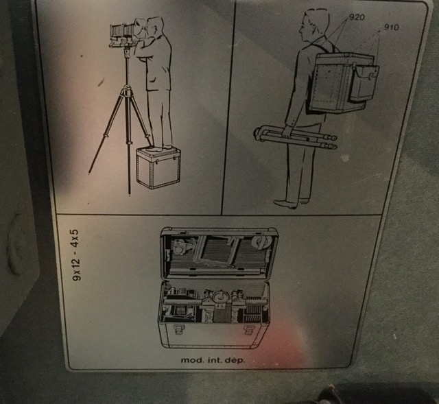

There was an early Sinar print ad or maybe an instruction manual or brochure that had a picture of a robust young Swiss gentleman hiking in the Alps with a hard-sided Sinar trunk case that apparently had lugs for backpack straps. I tried to find it on the net, but Google failed me.
David A. Goldfarb, I lol'ed at this. I blame the word "robust." And I'm considering your third option. I'm less inclined to do it for no other reason than it seems it may allow for more of a chance of what is technically called, "crushage." This not a rational fear as there's probably an equal chance of crushage with my baby carrier idea or pretty much any other option outside of a bank vault. But this is emotional---if I fall down the side of a mountain, the damage to my camera may not be the first thing I worry about, though it's quite likely that it would be second or third. So I will ponder option three some more because I think it has merit once I get over myself.

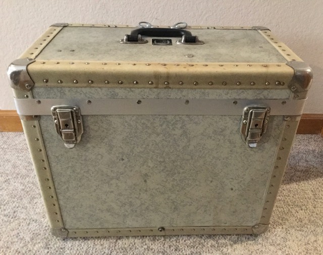

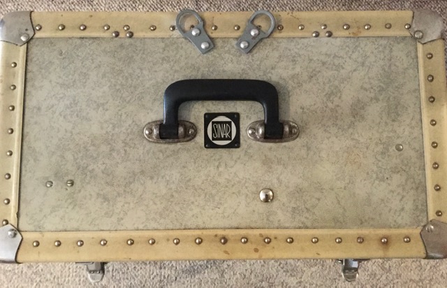

Here are three pictures of a Sinar hard case. The first is from inside the case and demonstrates the case being used as a backpack. The other two show the outside of the case with the D-shaped lugs to attach pack straps to on the top. There are two additional D-shaped lugs on the bottom of the case. I've never tried carry this on my back; it looks pretty uncomfortable. From the drawing, it looks like Sinar provided the straps and a pouch to attach to the outside.

I was on glennview a few weeks ago looking for lenses, cases, and maybe a couple of levels to replace some dried-up ones ($60 each from him) and I saw that illustration. I actually thought, "That would totally hurt."
Is that your case, though, Keith Pitman? If so, have you ever stood on it like in the picture? Looks like a lovely drawing of a lawsuit about to happen. Still, neato and thank you for showing it.
I had 3 of them for 45, 57 and 810 Expert kits back in the 60s but I never tried to back pack them and they did not come with straps or pouches. But I did stand on them.

Yes, as Bob implied, they are very sturdy. No worries about standing on the case. Anyway, who are you going to sue about a 40+ year old product?
Especially since Sinar has been sold twice and is now part of Leica and they would not have liability anyway!

Keith ... weren't the pyramids of Egypt made that way? The only way one would take a step forward was by flogging them. That doesn't look like backpackable, but torture.
View attachment 239174 View attachment 239175 View attachment 239176
Thanks for the photos that demonstrate how this arrangement actually worked. The picture I recall was less instructional and more advertising with the robust photographer and a few of his friends with a scene of the mountains in the background. I don’t recall whether they brought along their St. Bernard with a cask of brandy around its neck.
