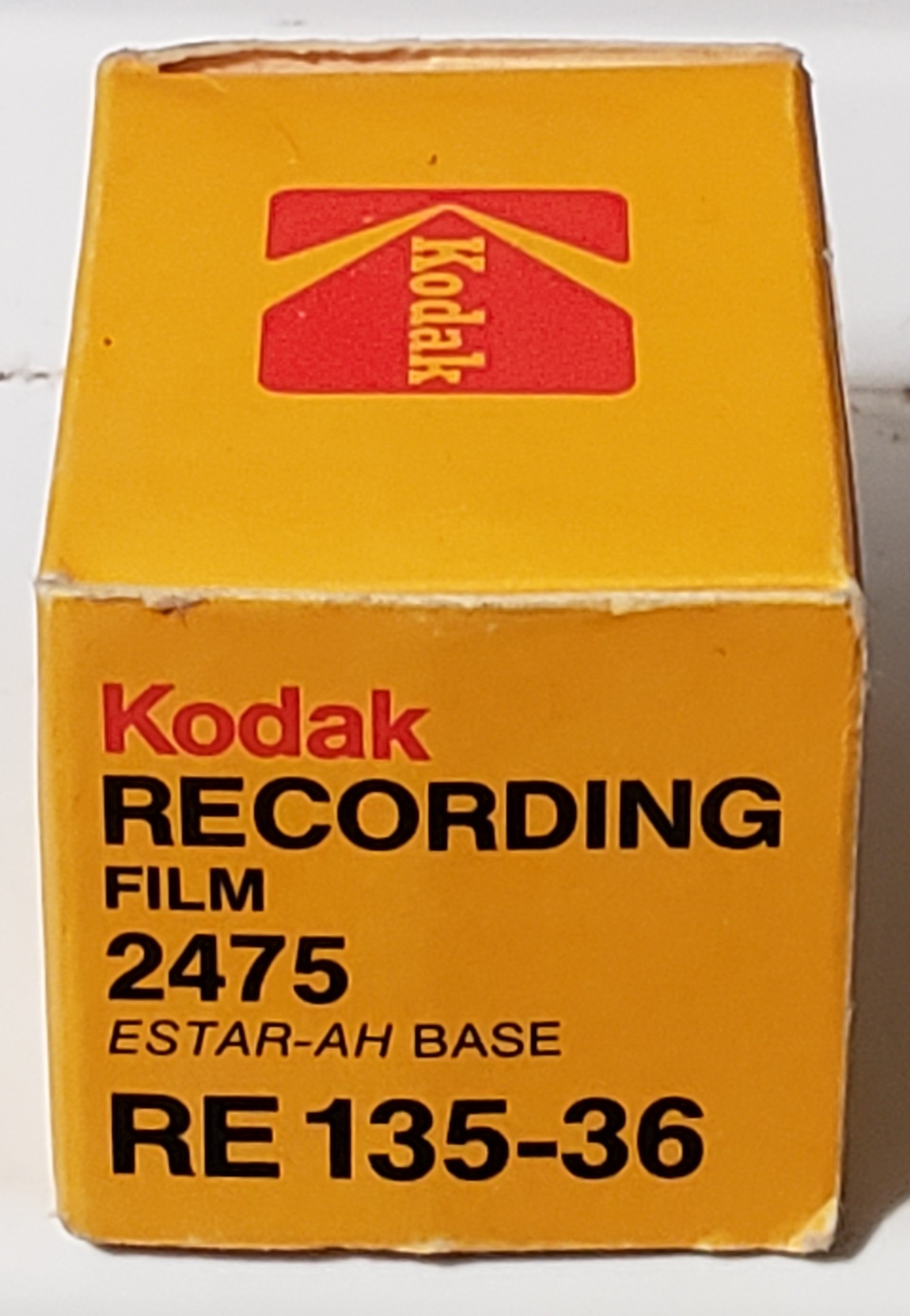

I'm disappointed.
I thought this thread was about something else. 🤣 🤣
