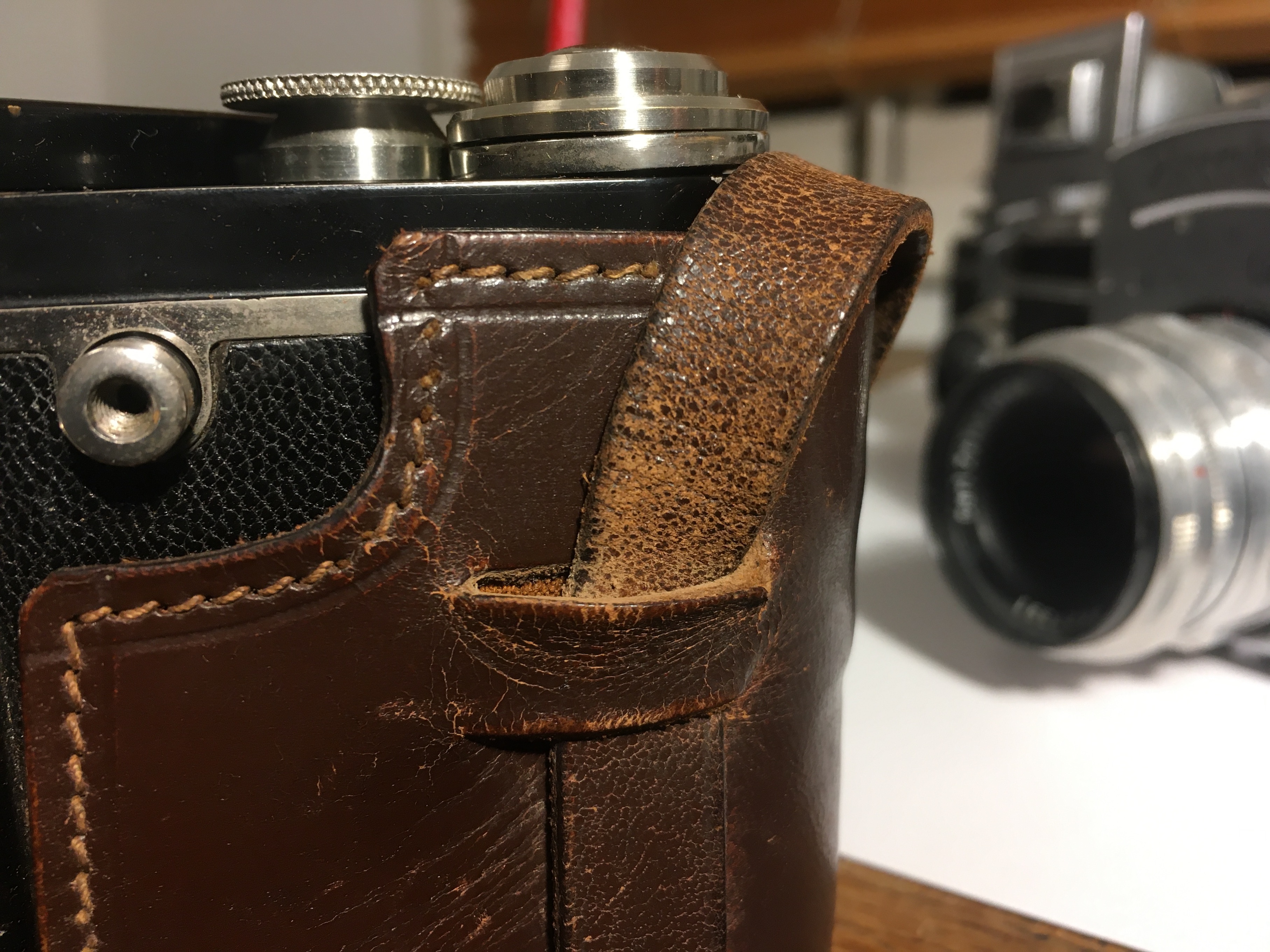

Quite a few of my older cameras with cases have straps that are very dry and flakey in places. Is there anything you can do to recondition these/ensure they'll be less likely to snap?
Thanks!

When the leather starts cracking I get it replaced. I have a Hasselblad 500mm lens case that had cracks including the strap and a leather hinge, so I took it to a shoe repair store. The owner partially disassembled the case and rebuilt it with leather that matched the light yellow color. It looks like it was never worked on, almost new.
As Mr Glass says, once it's gone it's gone.
You can reinforce cases, replace stitching if the leather is still ok, but for straps it's best to replace if you wish to use.
I generally fix up original cases and straps as best I can and leave them at home if they are in poor condition and just use modern straps if I have to.
Neatsfoot oil does a good job of making old leather supple. Applying Neatsfoot oil to new leather keeps it from cracking and probably preserves its strength. However, I don't think that there is anything that will restore the strength of old cracked leather.

Lexol is a great product for conditioning leather. it doesn't leave a greasy residue like neatsfoot oil. If you search on the internet, choose a product that is recommended for leather furniture or leather car seats. I really haven't used neatsfoot oil since i was softening up a baseball glove.
It does depend how far gone the strap is....as suggested, if it's badly cracked, no conditioner will help

You can also try Lexol or my favorite, Ballistol. Everyone should have a bottle of Ballistol around.
My favorite leather restorer is still good old mink oil. I just apply, let sit, sometimes apply a bit of heat with a hair dryer, after a good while, I just wipe it off. Re-apply if needed.

As others have noted; leather that is cracking like that basically has little strength left and will break easily when softened. I used to try to rescue them out of a sense of "authenticity" but after having most of them snap, I no longer feel so inclined.

I used to restore old military rifles and Ballistol is excellent, along with neatsfoot oil, to bring back the life of leather slings and ammo pouches. But as folks mentioned, if the leather strap is cracked and dry, lightweight in the hand, it is likely too far gone. Never trust completely dry leather. Replace.

...if the leather strap is cracked and dry, lightweight in the hand, it is likely too far gone. Never trust completely dry leather. Replace.
I'll do a 'snap' test (my own word, nothing official). Push two points of the strap together then pull apart quickly, make the leather snap. This will make dried leather obvious. Include connection points- lugs, buckles, etc. If it can't handle this it might not handle stepping off a curb and having the camera drop a few inches.
