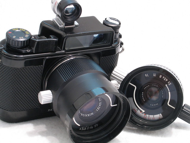

The Nikonos III is a fine waterproof camera. When I first bought mine, it needed service. I used Bob Warkentin’s Southern Nikon Service Center in Houston, Texas and was very pleased. However, I do not know if they are still in business.
www.southern-nikonos.com
Nikonos III by Narsuitus, on Flickr

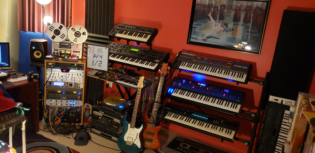

I was just about to shoot a test roll inside my music studio. I have a whiteboard setup 11 feet away from my camera, and I'll be writing the current photo's aperture and exposure on the whiteboard -- while the lens focus is set to 11 feet
I was going to do the following photo combinations:
f/2.5 -- 1/500, 1/250, 1/125, 1/60, 1/30
f/4 -- 1/500, 1/250, 1/125, 1/60, 1/30
f/5.6 -- 1/500, 1/250, 1/125, 1/60, 1/30
f/8 -- 1/500, 1/250, 1/125, 1/60, 1/30
f/11 -- 1/500, 1/250, 1/125, 1/60, 1/30
f/16 -- 1/500, 1/250, 1/125, 1/60, 1/30
f/22 -- 1/500, 1/250, 1/125, 1/60, 1/30
which puts me at 35 photos -- perfect because I'm these superia 400 rolls have 36 exposures hehe
Do you think these are good test shots to be doing, or do you have any other recommendations? Should I keep the whiteboard at 11 feet all the time? or should I put it at 5 feet for some shots, and 11 feet for others? etc
Here is the scene I would be shooting for these indoor test photos. Taken with my phone camera -- without a flash. Please suggest any changes :smile:
That is sweet!

I would not test anything until you get the light meter so you know what initial settings are correct for proper exposures. Make sure the light meter is calibrated correctly first.
Thanks! I'll wait then. Good call :smile:
I don't see the point of doing indoor shots. Most of them are just going to come out too dark. If you want to check shutter speed and shutter accuracy, outdoor shots should be sufficient. Plus you be able to check a larger range of settings.
Well, the point of indoor shots is that I'd like to use my camera indoors a majority of the time. And I'd like to know what settings to use for them :smile:
Looks like the next Ulrich Schnauss...
