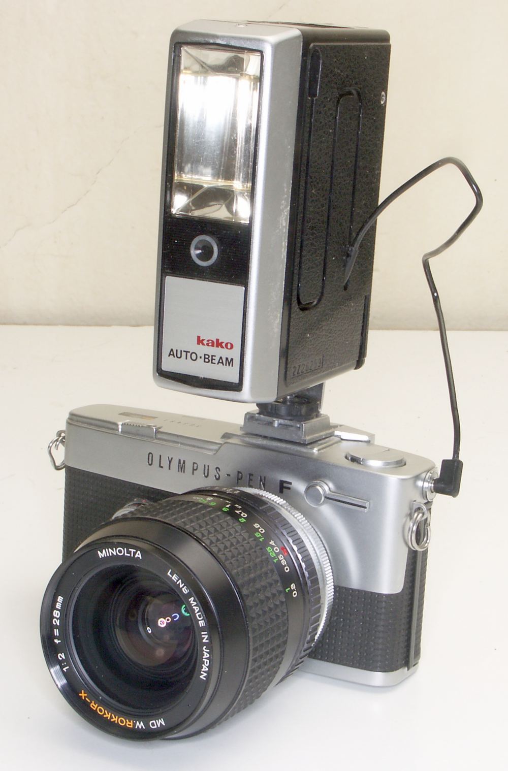

If you are still looking for a "period" flash, here's one you can have for the price of postage -- probably $5 or so. It's a KAKO Auto Beam. It uses FOUR AA batteries OR an A/C cord for power and has a GN of 100 with ISO 100 film in feet -- pretty good. It has a locking cold shoe and built-in PC cord. It has a test button and a ready light. Also has manual & auto mode -- with a rotating calculator on the back. It also can be used vertically (perfect for the PEN F) or horizontally. Oddly enough, no ON/OFF switch. BEST OF ALL, IT WORKS -- comes with A/C power cord, but AA batteries not included.
If DASH isn't interested, anyone else can have it. Here's a shot -- it works on other "PC connection enabled" cameras too.
DASH,
