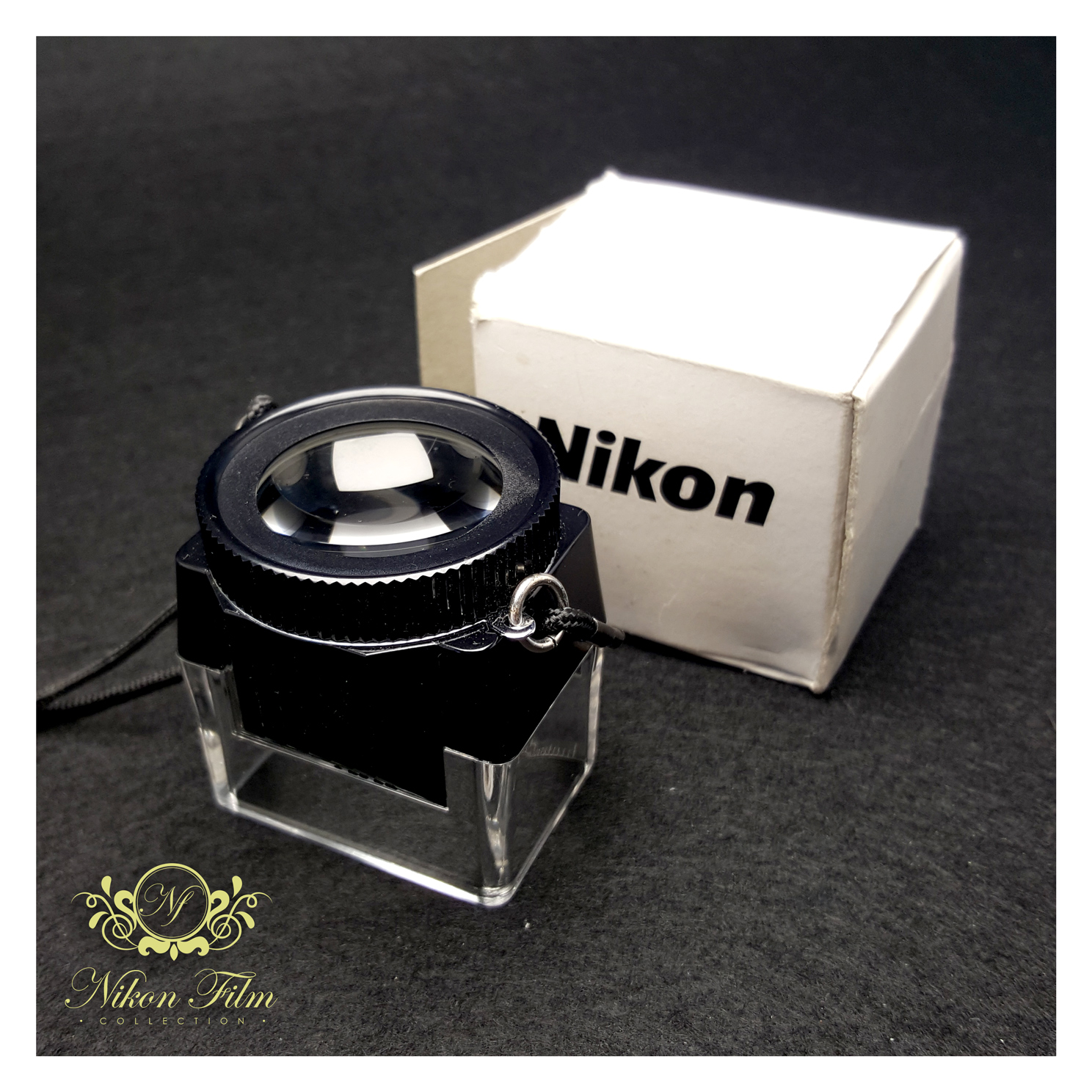

I use a Nikon loupe, that's been w me since the Kodachrome era. works like a charm

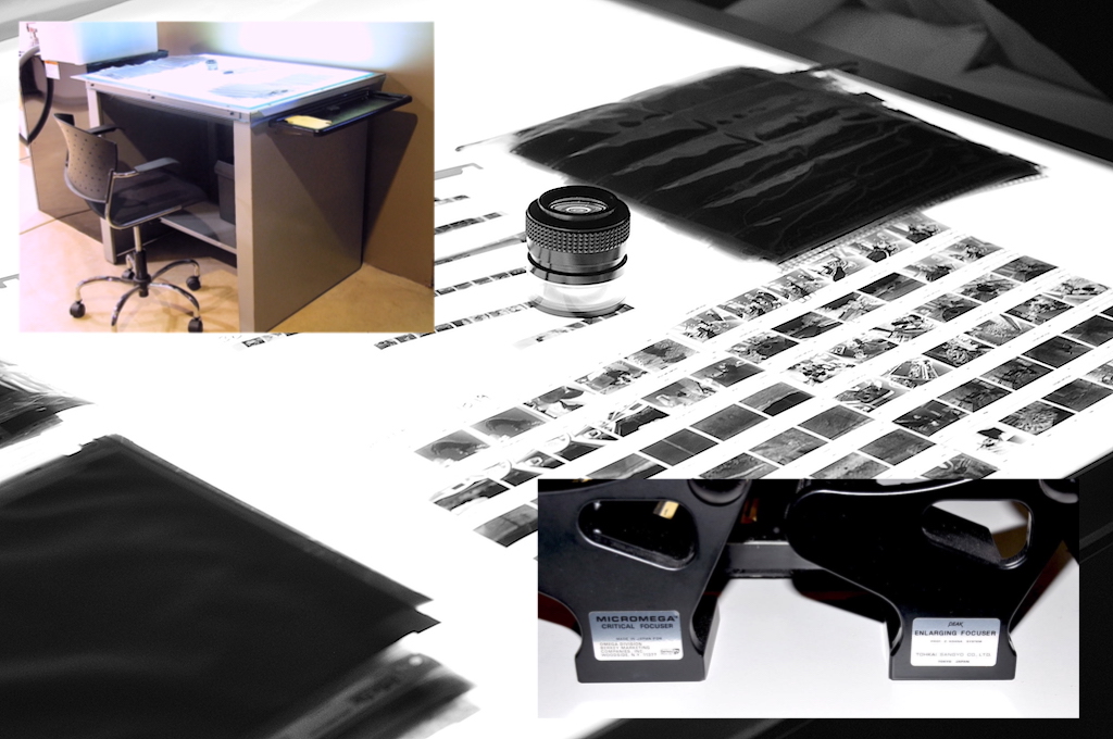

Light table, loupe and focuser...I couldn't live without these things.
There are many options out there but this is what works for me.
Nuarc light table, Kenko 8x loupe and Peak or Micromega focuser.
I have one of each Peak and Micromega and they are the same thing with different stickers on them.
The Nuarc table is a little big but was free. Apparently the graphics arts folks don't use these any more now that everything is computerized.

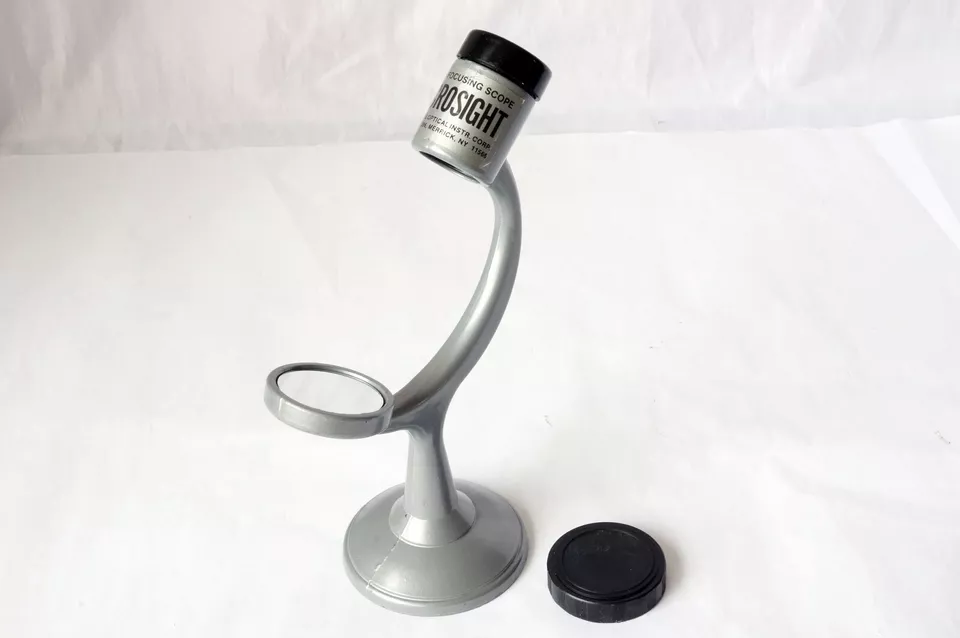

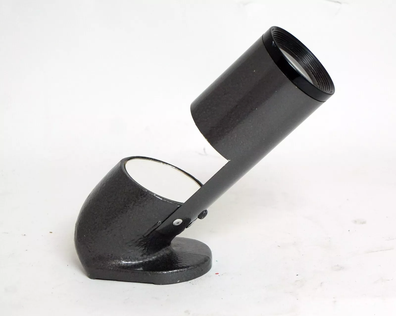

At home, I use a Bestwell Micro Sight mostly - it works well for me. It is nicely complemented with a Bestwell Magna Sight - which helps get me close when the enlargement moves the focusing control a long way from the easel.
The Micro Sight:
The Magna Sight:
