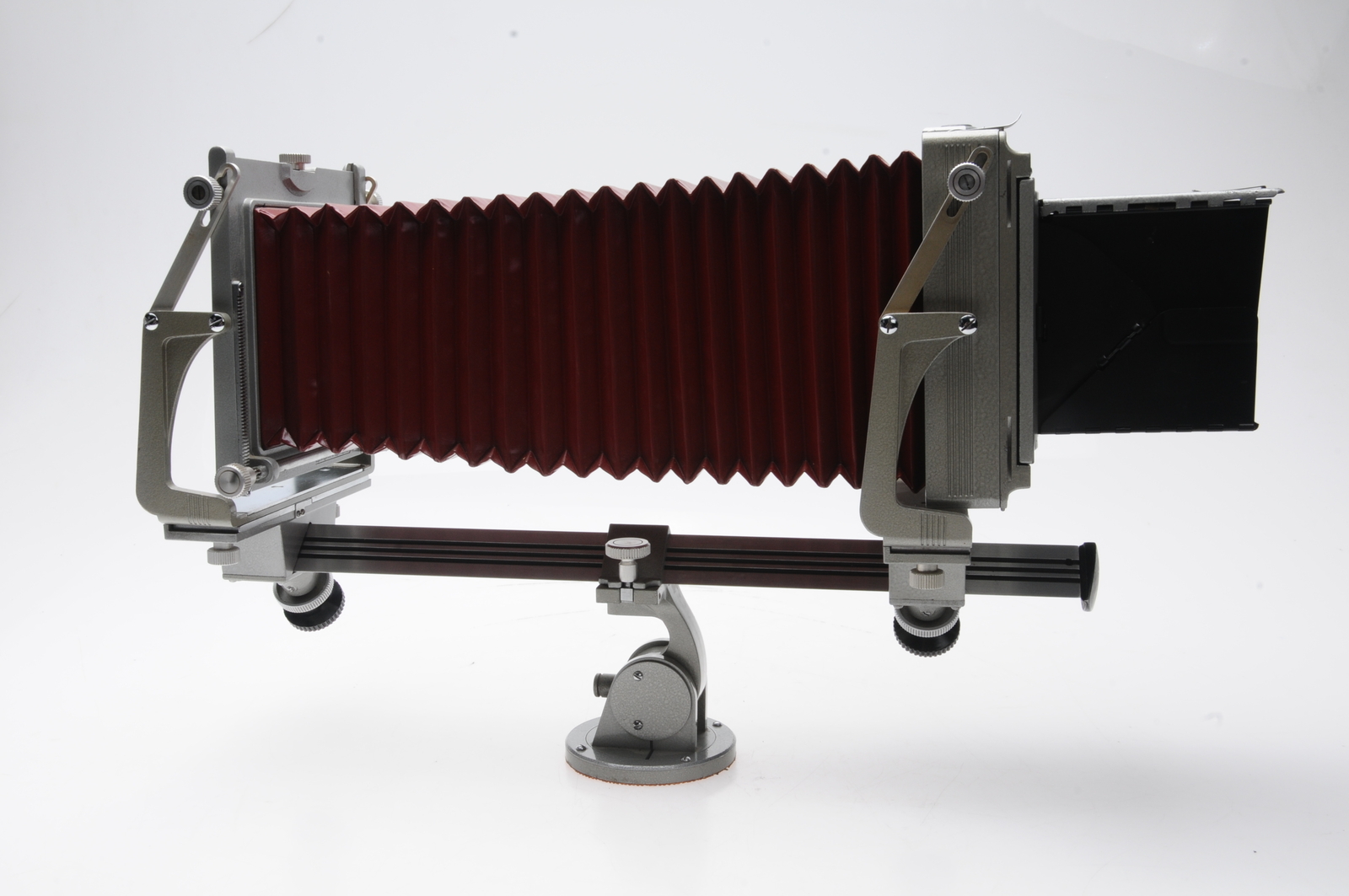

Relative inexpensive is the Graphic View, no frills, takes standard Graphic lens boards, has good movement, somewhat portable, but unlike the Speed or Crown not handholdable.
The one shown is a Graphic View II (centered tilts vs. bottom pivot tilts on the first version). Many of that model also come with Graflok back, but the easy clip-on back can be switched if you have a camera without and can find the back for it. IIRC, the bellows are easily removed as well, though I don't know that I've seen a bag bellows for these.
I've got one of each; the original is very usable, but if you have the choice, I'd recommend the Graphic View II with the Graflok back for the additional ease of movement use and versatility.
FWIW, I recently paid under $200 for my GVII with Graflok, including a 270 mm tele lens in a shutter that needs CLA.
