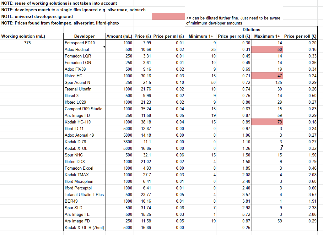

A while ago I made a spreadsheet of most developers that was available to me to find the cheapest
1. Rodinal (1+50)
2. HC-110 (1+79)
3. Ilfotec HC (1+49) / ID-11 (1+3)
I ignored FD10 because it's not something I ever want to use again.
Which goes to show this is location dependent. You paid 50% more (if not a bit higher) than I do for Xtol (current new stock at Freestyle $11.99 per 5L package). Even if you figure in shipping, buying a couple bags and some film to dilute that out makes it significantly less than you're paying. Get it from B&H and make a total order of $50 or more, and the shipping is free (in USA, anyway).
1. Rodinal (1+50)
2. HC-110 (1+79)
