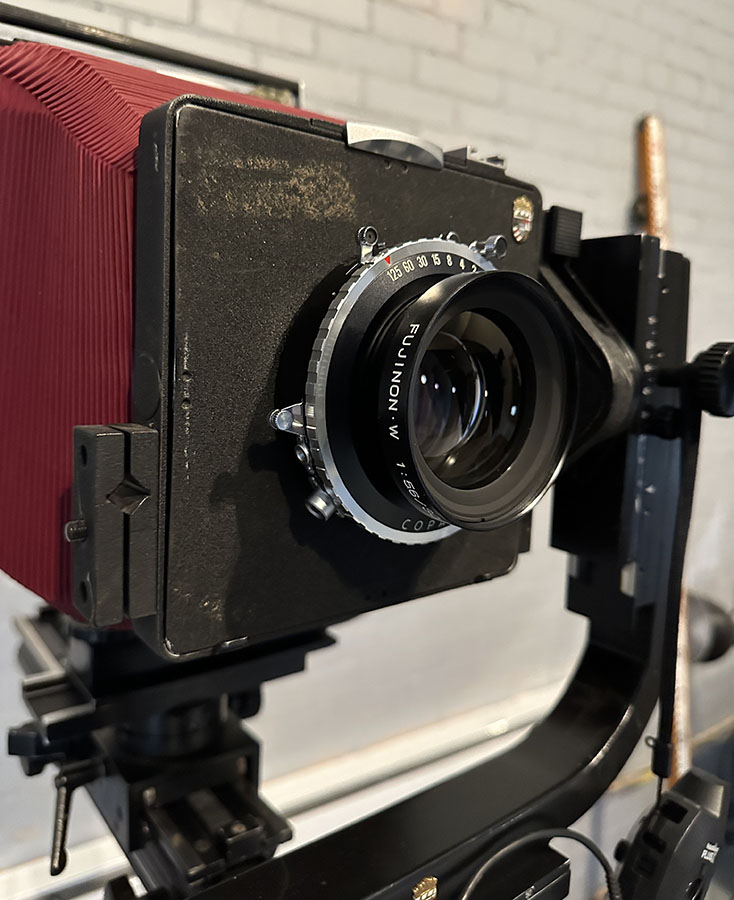

I have been using a 240mm and recently purchased a 300mm f5.6 W Fuji and did some studio portraits with it, mostly upper shoulder portrait work and I am very happy with the results.
