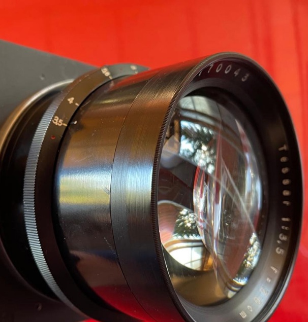

Tessar 4.5/300mm coated is a good choice. I also have a rare Tessar 300/f3.5 and 250/f3.5 aluminium models (uncoated but incredibly light).
The choice of lens depends a lot on what to shoot. The 3.5 gives a more soapy picture, but for portraits this is sometimes a good thing.

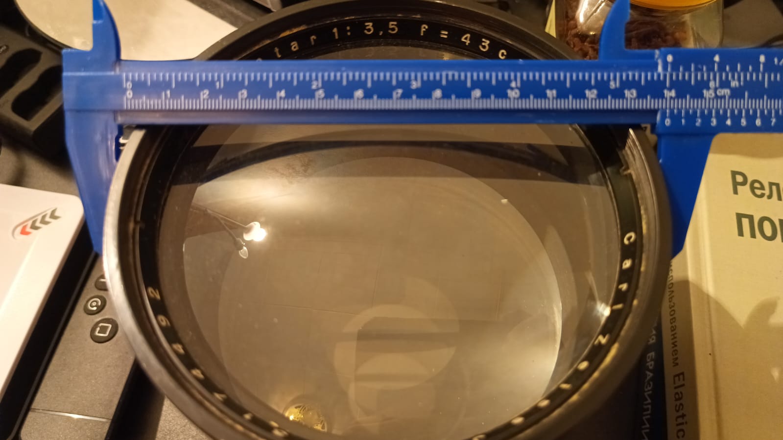

For portraits, I also recommend the zeiss epiotar 43cm/f3.5 (no aperture, but you can set it if you know how.
Both can be installed into sinar shutter!
