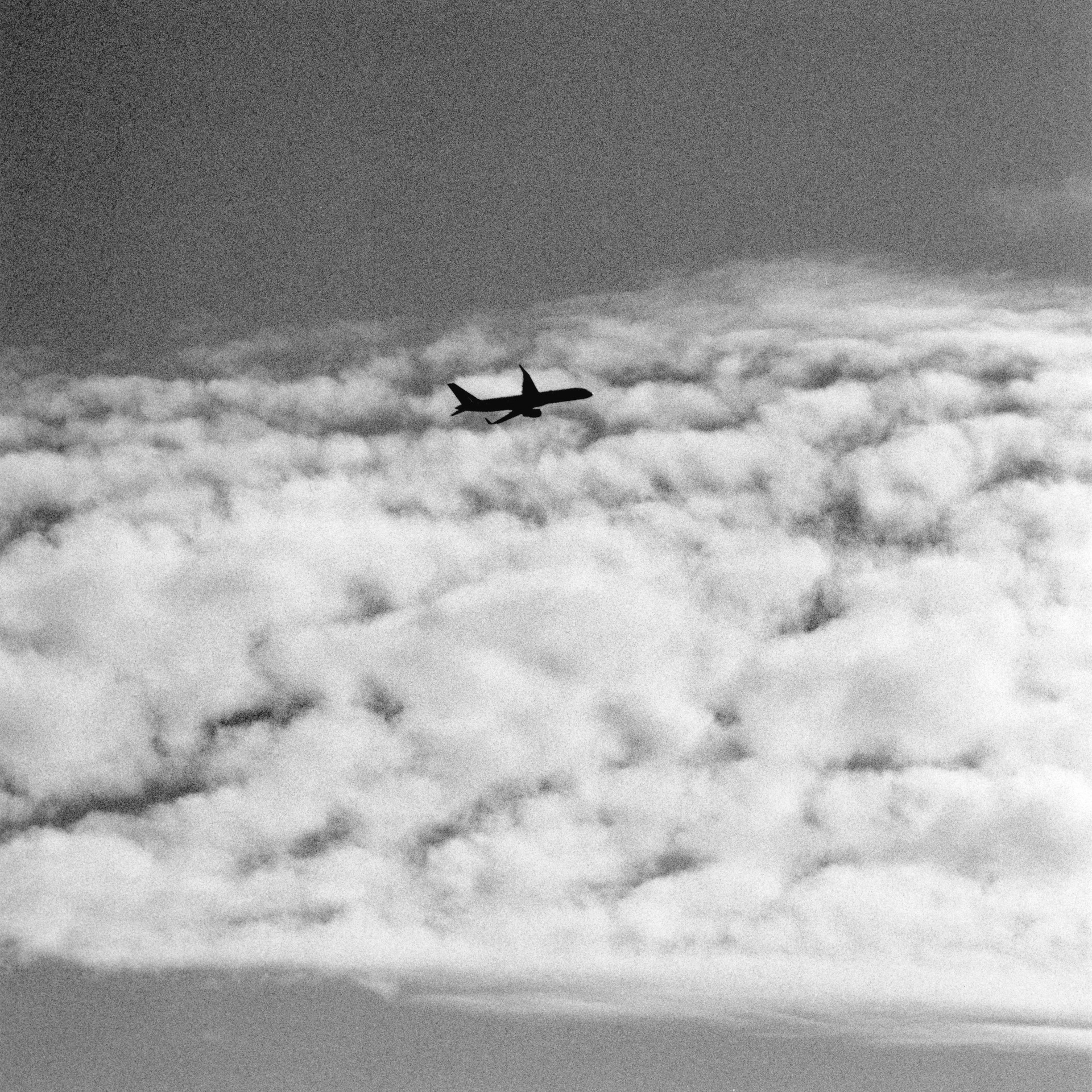

Super8
An example of medium format, very little cropping. Bergger Pancro 400, Rodinal 1+50. Printed hard.
