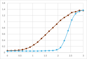

And classic cyanotype has a fairly steep curve, which means that it'll produce fine prints from a negative of moderately low contrast.
Classic cyanotype HD curve in blue, from here. Grade 3 negatives tend to work great for classic cyanotype. The curves of New Cyanotype and Simple Cyanotype are different, and longer (esp. New).
