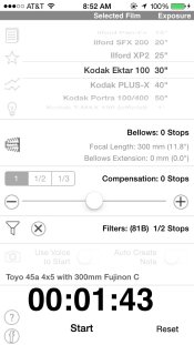

If you have the iPhone you should seriously consider getting this app, I use it for all my LF and Long Exposure work.
Reciprocity Timer App
https://itunes.apple.com/us/app/reciprocity-timer/id459691262?mt=8
This is the kodak data sheet but you're right there's not any serious long exposure info on their, strange... It's almost always in the data sheet...
http://www.kodak.com/global/en/professional/support/techPubs/e4046/e4046.pdf
The app is almost always spot on for exposure times, I HIGHLY recommend it and it was designed by someone on the LF forum, there's so many options it's almost too full for the screen size if an iPhone but the info for exposure is always correct from my experience.
PS I just looked on the app and it says this...
However at that amount of time I would think that using a color correction filter would be needed which would extend the time further... If I had to guess, an 81B filter? If it's a newer industrial complex with slightly fluorescent / whiter lights and not tungsten?

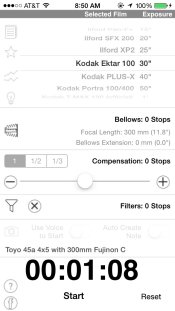

Thanks. I looked at this app earlier today and wasn't sure about it. But I bought it now, looks pretty cool indeed.
Just to double check the app' results with you. I selected Kodak Ektar 100 and a 30 seconds exposure time. I don't have any additional variables like bellows, or compensation. So the app shows me 1:08 min. So that would be my exposure time then? That is friggin' cool and simple :smile:

Yep, you just missed my second post (look above).
Yes if you don't have bellows to deal with just leave those sections alone.
I know a while ago someone was having trouble with the filter options, to my knowledge the designer has updated the app to fix it, and if you add filters you need to remember to hit the + symbol after highlighting the filters in the filter area or they won't actually apply, so the app is a little quirky but it works well.
