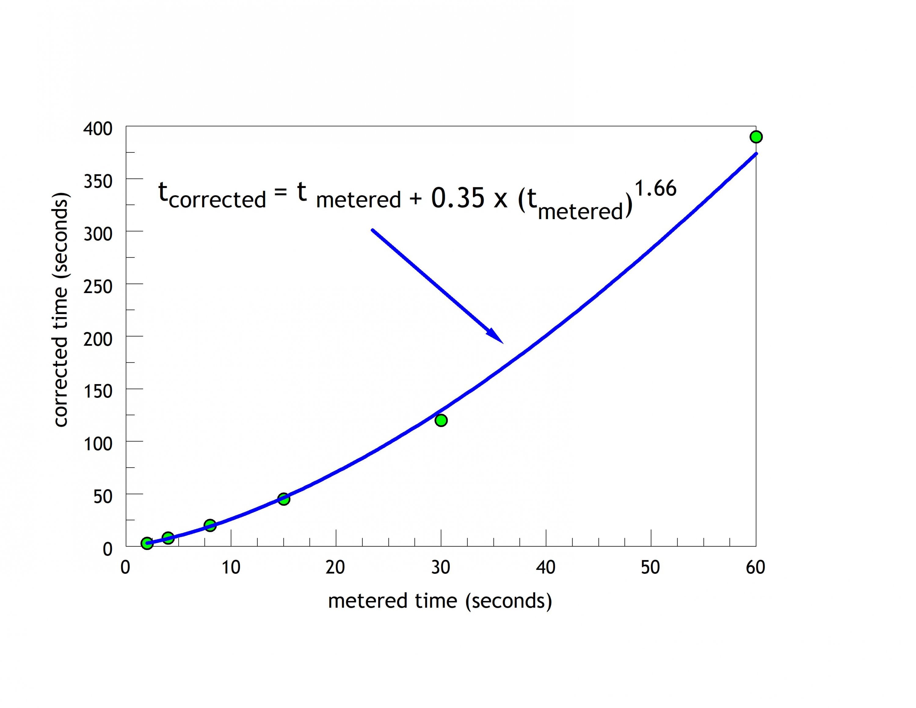

Here's another function that fits the Adox CHS 100 II data quite well. The equation is given in
the attached figure. I used an equation similar to one that Gainer used, except that the exponent was a variable parameter (which optimized to 1.66) rather than being a constant as used by Gainer (1.62). I optimized both the factor (0.35) and the exponent (1.66) to fit the data.
Here's another function that fits the Adox CHS 100 II data quite well. The equation is given inView attachment 278438 the attached figure. I used an equation similar to one that Gainer used, except that the exponent was a variable parameter (which optimized to 1.66) rather than being a constant as used by Gainer (1.62). I optimized both the factor (0.35) and the exponent (1.66) to fit the data.
Thank you for sharing. Very useful .
