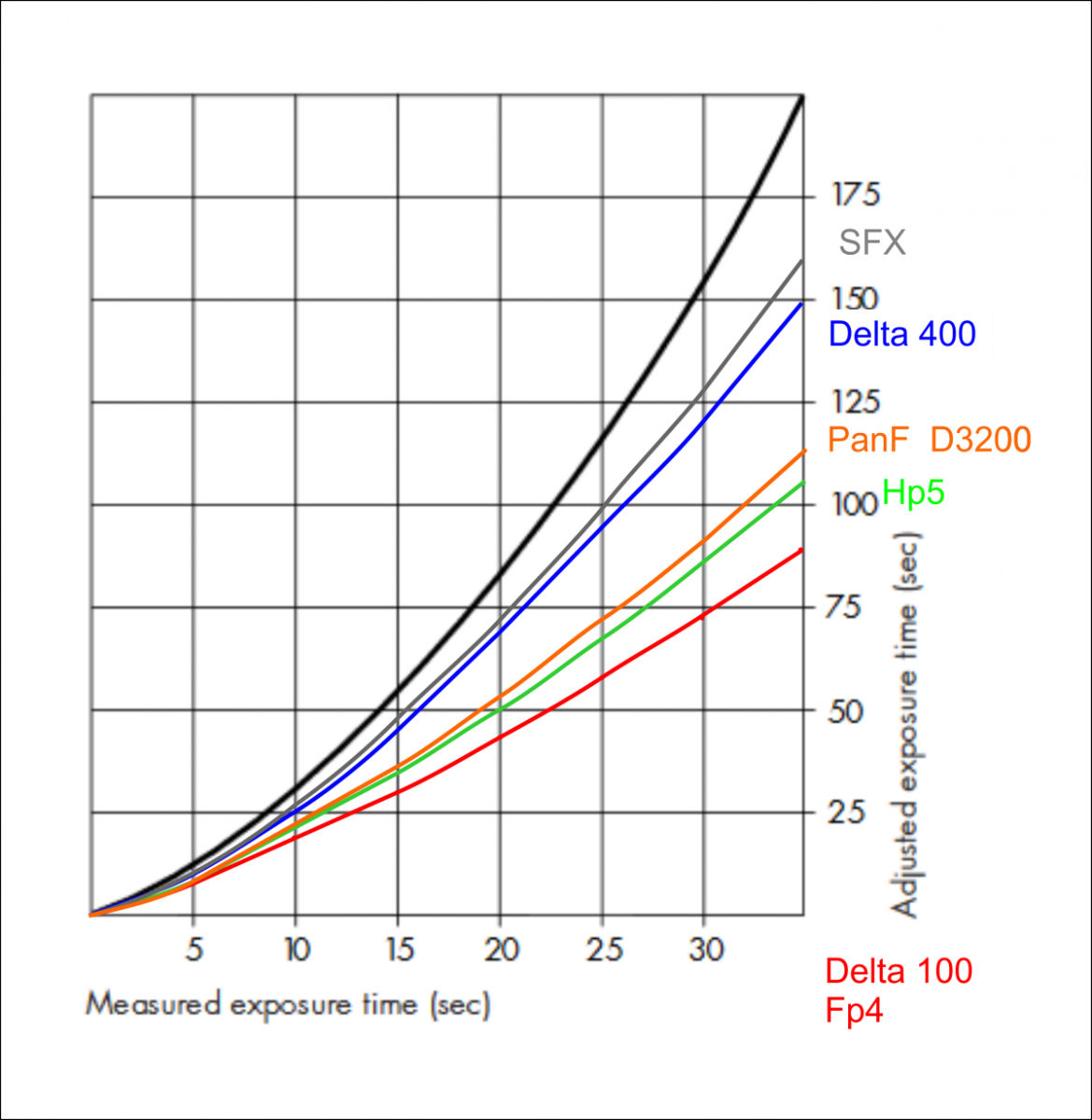

Ilford publish a generic Recirocity table for all their films, I added the new factors and drew the comparisons here:

Thank you for posting the chart and information. I think some of the confusion stems from the older Delta 100 Tech Data Sheet, which showed the generic curve. That curve gave very different compensation factors, as shown in your chart. For a 30 second metered exposure, it called for 155 seconds. Quite different from the 73 seconds you get with the new factor.
