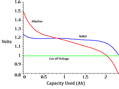

The discharge curve for NiMH batteries is much flatter than the one for alkaline:
