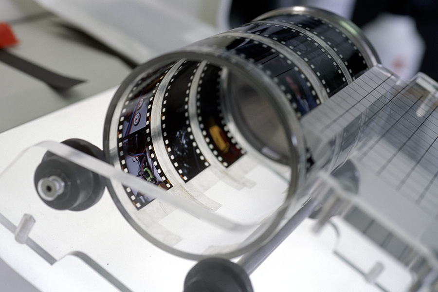

..what exactly are 'sciencescan.com' selling for the 9000 ED? I think it would need to be a dedicated carrier with a piece of glass about 3in wide. I don't really understand how the film would be kept flat unless another piece of glass was used ontop
to form a sandwich. It's different on a drum scanner, where the film is pulled tight as it is wrapped around the curved glass surface.
