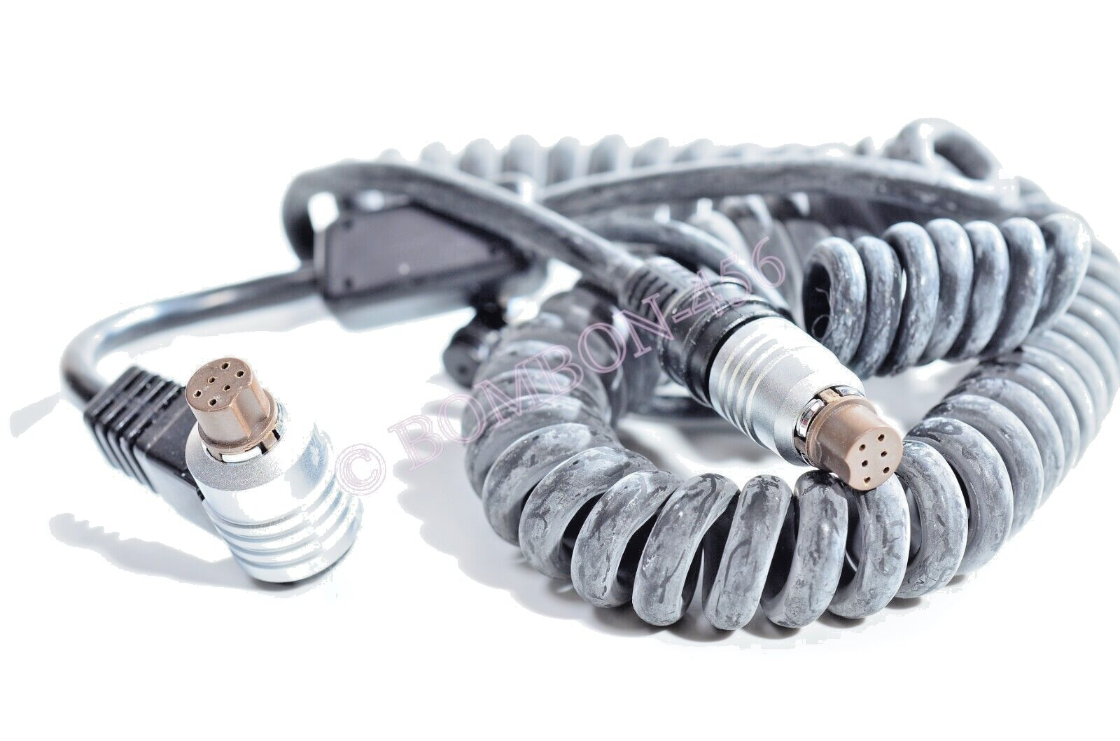

I have an odd question. After years of searching I finally found the Y-cable to enable TTL metering in the Hasselblad ProFlash. A sample image of such cable is shown below. However, the cable is well-used and the plastic insulation is tearing at a the flex points. If I continue to use it as-is I doubt it will last very long.
Meanwhile, the connecting plugs are quite robust. As far as I can tell they're also proprietary. Which led me to think: is it possible to build a new Y-cable but re-use the plugs?
Is there a service that can do that?
Thanks!
Sometimes, the plugs can be disassembled and the conductors desoldered from the lugs inside. It's then possible to build a new cable, but the flex part will of course still be broken. As I understand it, the cable still works at present. Maybe just reinforce it physically so that it doesn't flex too much and keep using it?
Before cutting the cable or undoing the plugs, buzz out the pin sockets with a meter. If you do not have a meter use a battery and torch bulb.
Write the results down, do not trust your own memory.
On the machines that I have worked on in the past it was not uncommon to find crossovers in the wiring. That is, the pins may not be wired a-a, b-b, c-c, d-d, etc.
It would be nice to know how you get on.
Depending where the insulation is being damaged (and how much of it is being damaged), you may be able to bolster it with glue gun (I know - sounds weird - but it works).
Those connectors look like they can be dismantled. I'd be careful of where the plastic connector clips into the metal housing - it might be quite brittle by now.
