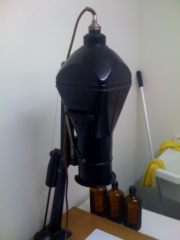

i'm trying to find out wich enlarger i have. I found it in my grandparents home, it was used by my great grandfather. That's why i think it must be a really old one. Does someone have a catalogue where i can look at it?
I will post as soon as possibile a picture of it. The enlarger is black and mount a Rodenstock 50mm, i guess.

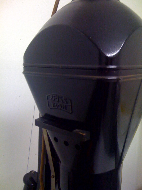

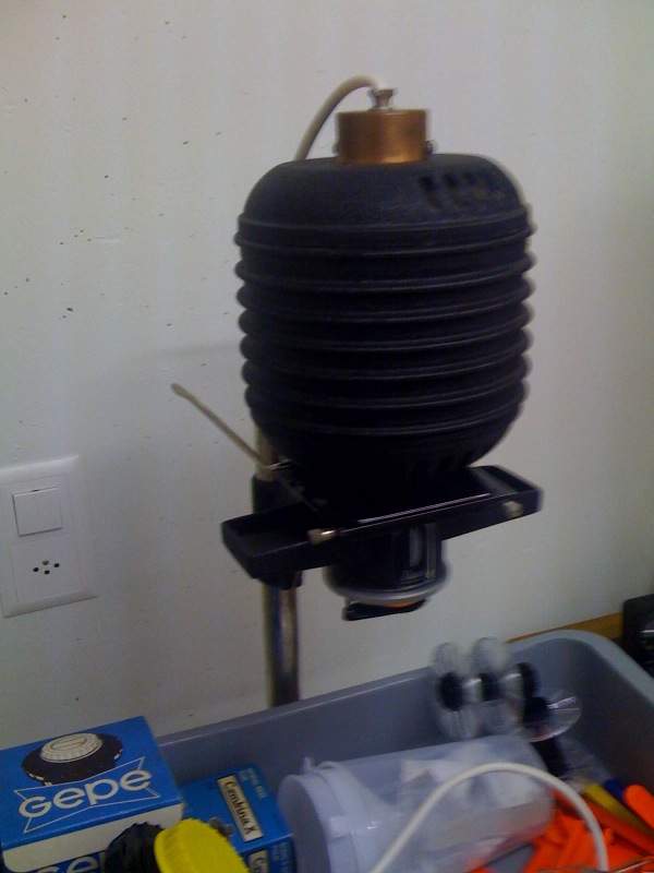

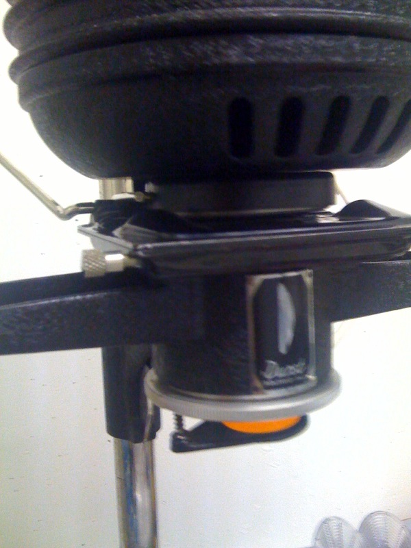

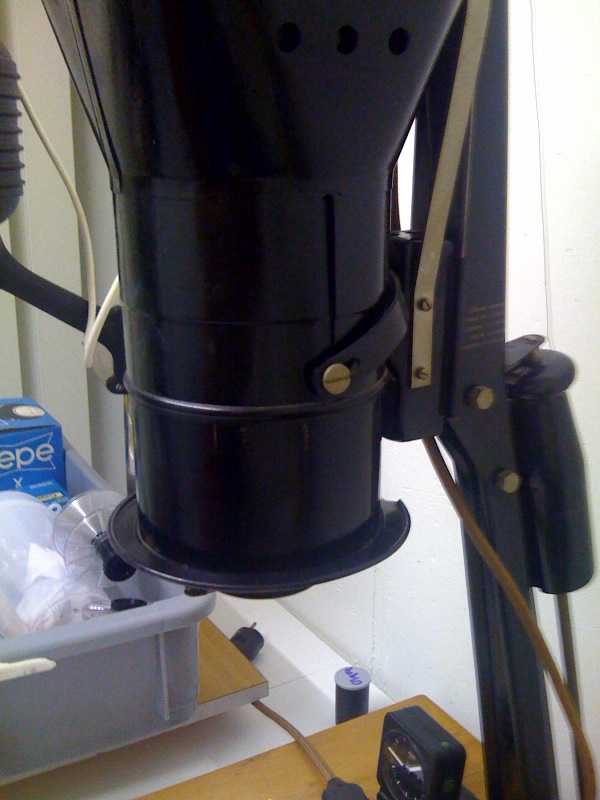

Here are the pictures of the zeiss enlarger and last two are of a Durst that i don't know the name of.

The Zeiss Ikon (no hyphen) enlarger appears to be a Miraphot, which was first made in the 1930s. I have two of Zeiss Ikon enlargers -- for 35mm and for 120.
I was going through some literature yesterday and came across a photo of what appears to be your enlarger. Send me your e-mail address through APUG, and I will scan it for you.
Is this the enlarger with the Rodenstock lens?

the zeiss ikon mount a novar anastigmatic lens, it's the durst that mount the Rodenstock, i apologize.

It looks pre-WWII, I just went to look in a 1935 BJP Almanac but Zeiss don't list an enlarger. Try the Zeiss catalogues on Photoeccentric.

What numbers are on the Novar lens? I believe this is a medium format enlarger from the 1930s. It should keep its focus as you move the entire unit up or down to change the size of the enlarged image.
It does keep the focus. I like it.
The lens says 1:6,3 F=13,5cm and the number is 1311425.

Oh wait, that should be usable for 120 film and for other negatives up to 6cm x 11.5cm and even 9cm x 12cm, because it's a 13.5cm lens.
Zeiss Ikon's "D" cameras (6x11.5) used a 13.5cm lens. I think the 9x12 cameras, such as the Maximar, Miroflex and others, used either a 13.5cm lens or a 15cm lens as the "normal" optic.
